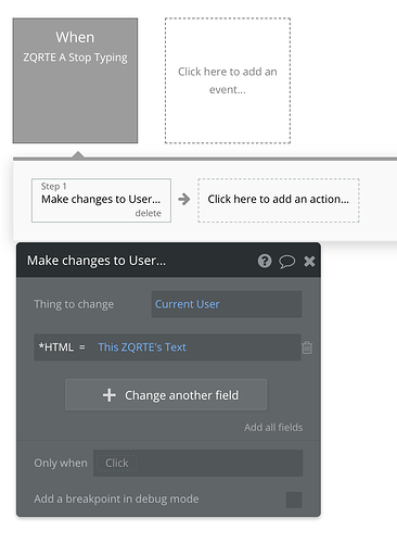

I’ve gotten reports from my client and just tested this. We use the Stop typing trigger to execute saving of the text in the editor to the database (as a replacement for autobind).
However, whenever that happens, the editor will jump back to the first character in the editor. This gif explains it best:

I’ve set up completely new element on a blank test page now, using the ZQ RTE element on version 1.61.0. I’ve sent you a link to the page in a PM where you can see if it’s replicable that way.
  • I’m not changing any settings on the element except for the Initial content
  • It happens both if I save HTML and if I save text
  • It happens both in Chrome and Firefox (Mac)
  • It happens in both the ZQRTE and the ZQLiteRTE elements

Hi @petter, we have found the reasons for both issues.
For Cursor skip, if you leave the Content blank, it will not reproduce the cursor reset behavior, indeed. Also, if you type some initial content as static:
It will still not reproduce this behavior, it works fine. The reason for this cursor reset, is actually in this way of introducing the content value:
As it is a dynamic value for the actual variable within your database, Bubble will refresh the app and reset all inputs from your app when you make the changes to the database, which is why it is throwing that cursor at the beginning. Unfortunately, it is something we cannot influence, as it is just the way Bubble works.
In order to solve it, it would be best to just leave it blank or you could set initial content with a static value.

Hey guys,
Sorry for my delayed reply, been a hectic week… first, thanks for following up, I really appreciate it.
For the cursor skip, I see what you mean that Bubble resets the input after saving. For now I’ve gotten around it by storing the initial content in a state and loading it from there, instead of setting a dynamic value as the initial content.

Hi @ZeroqodeSupport
Yes, sure. It’s very simple, so not sure if screenshots needed, but I’ll add if you want:
  1. On page load (or data type load) set a State of type text so that it contains the text from the data type field you want to edit
  2. Set that state as the initial content of the ZQEditor
As the state doesn’t change even when you save, the input remains ā€œundisturbedā€ by Bubble’s element reset that would normally cause the cursor to skip.

Hi @petter,
Thanks a lot for your feedback! This workaround is very handy. Additionally, our development team has managed to fix this cursor skip issue within the plugin itself. Please upgrade it to the latest version, refresh your app and give it a try, without necessarily setting a state. You could simply insert dynamic data into Content field, so even if you make changes to the database and it gets updated in the editor as well, the cursor will not jump anymore.
