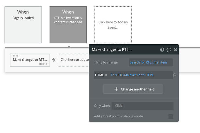

Hi, here is a solution for this:
for the workflow that saves the changes to the database, don’t run an action to set initial content of the editor. Only run it once at the page load, like this
and for saving the changes just run this
in this case the cursor position will not be reset each second

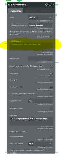

I set my initial content directly in the RTE settings.
I cannot set my initial content with Set Initial Content RTE-Mainversion action because my RTE is in a Repeating Group.

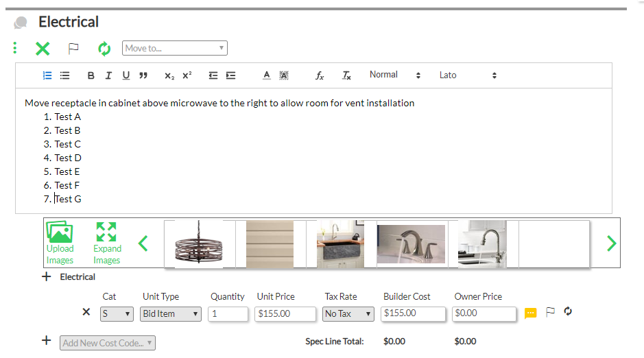

You’ve fixed the cursor issue, but broke the auto resizing. When my page loads, I get this:
When I start editing the RTE box, it then resizes itself, like this:
Do you still want access to my app? I’m not sure how to make that happen other than changing my application rights to “everyone can view” or “everyone can edit.” I’m currently on a personal plan.
