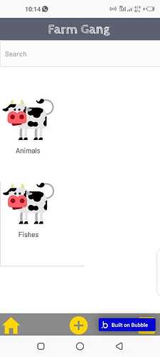

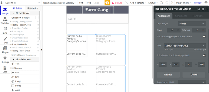

Hi everyone, I am having a problem with my RG. I have set it as 2 columns as below.
Index page Width - 380px , RG width - 380px

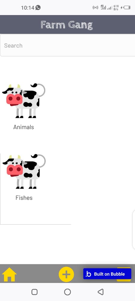

When I preview on my laptop browser, it display properly but on my mobile phone, it shows as a single column RG.
However, when I reduce the width to 360px, it displays properly on my phone.
What could be the reason for this?
How can I make sure it displays 2 columns on my phone using width 380px for the RG?

When I tried to uncheck the fixed width, the repeat group filled the screen on my laptop browser which I don’t want.
I am building a one page app that uses groups to show and hide the sections.
Any other ideas?
