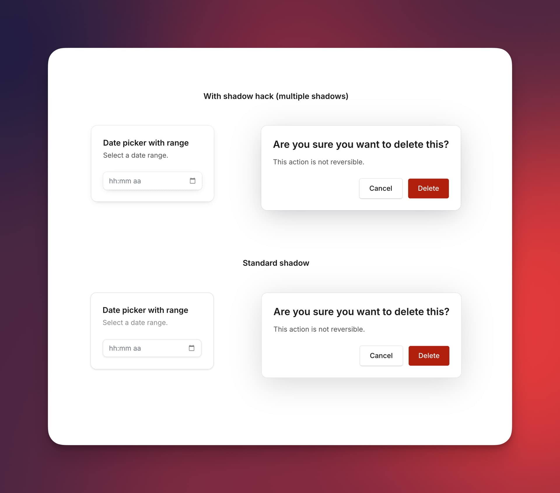

Result
Below is the result of layering multiple shadows on an element. The difference is subtle, but if you’re as obsessed with making things look elevated and polished like I am :laughing:, it might be worth the extra effort.
