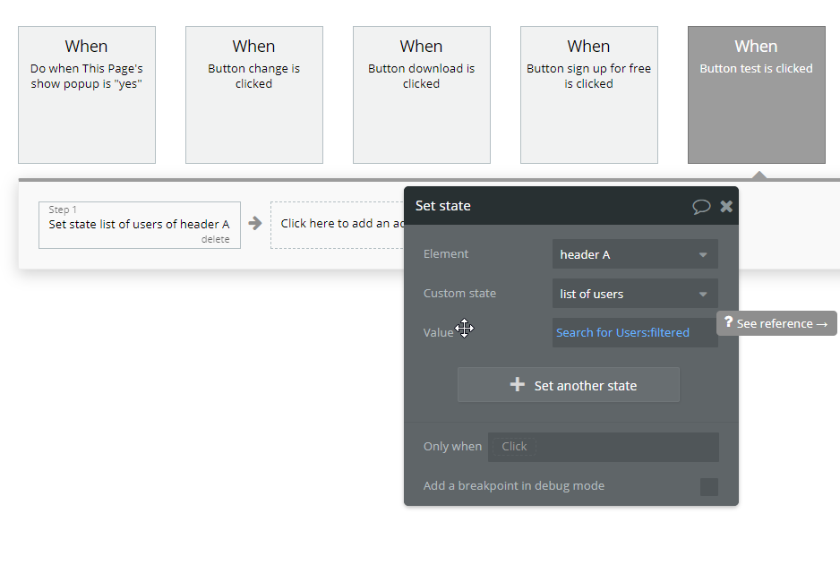

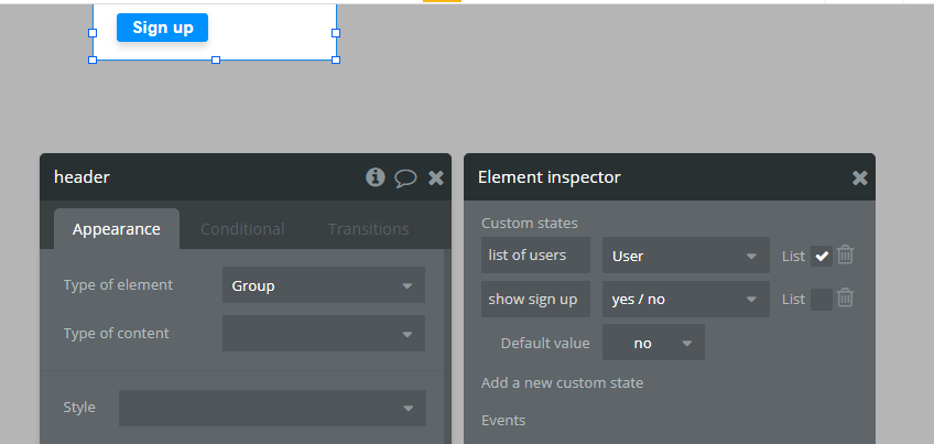

When you are using a reusable element on a page, the only state you can refer to, to exchange information between reusable element and page, is the custom state of the overall reusable element.
To reach this click on the reusable element, select i and select the entire element and configure a state there.
You will not be able to communicate directly between repeating group of reusable element and the page.
Therefore as the repeating groups data source, you could for example use a state for the entire reusable element.
Then on your page you can set that state of the entire reusable element.
Hope this helps, pm me if you need further help.
