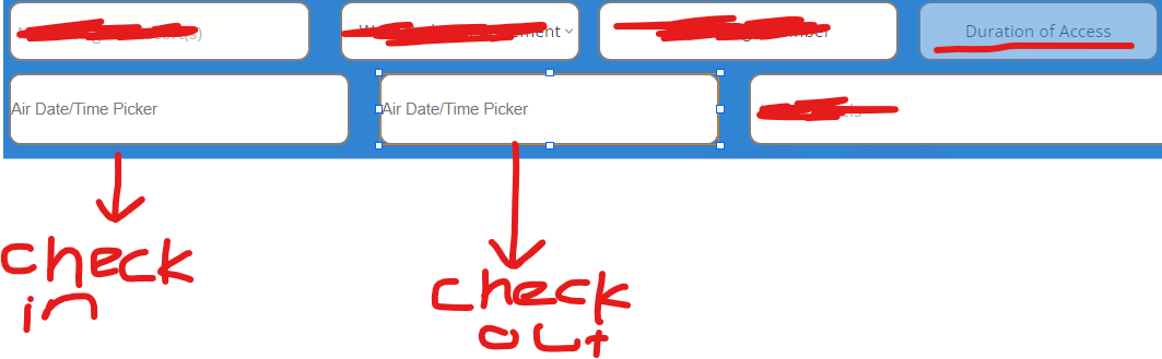

Currently, I am using the plugin:
I have a duration of access (how many hours staying) and a check in date, they together make the initial date of the check out date as seen with the display and code below:
Display
Code
Code
The issue is it works with adding hours, but I was hoping to extract the minutes from the check in date and add it to the code attachment above but get this error…
Error
Was wondering without any additonal inputs for adding the minutes (as I am out of space on the page) would there be another way of adding the minutes to the check out date.
Thanks
Hello @muellerme ,
Thank you for reaching out to us.
Based on your message, it seems you’re encountering some difficulties with setting up the expression in the Air Date/Time picker element, is our understanding right?
The “Initial date” field is designed to accept a Bubble value of the type “date”, which is a standard field type in many elements. If you wish to add “+ hours” to your initial expression, please ensure that the expression following “+ hours” is of type “number”, otherwise, it will not be accepted.
Hope this information is helpful to you. If you have any further questions, please don’t hesitate to ask.
Wishing you a great day ahead!
Best regards,
Zeroqode Support Team
That makes a lot more sense now, thought it would still be a date type. Thanks Zeroqode Support Team!
