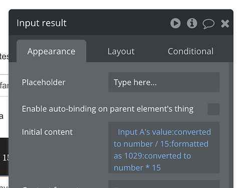

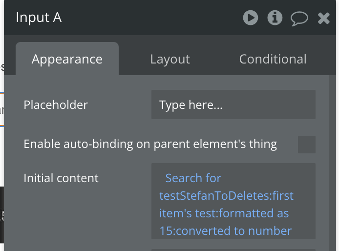

For example, you can first extract the minutes from the date as a number:

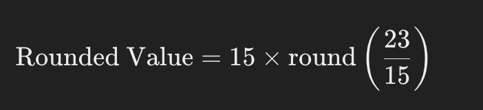

Then apply the formula that will give you the rounded number to the closest quarter hour:

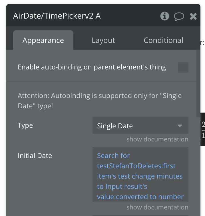

Finally, in the Air Picker element, simply change the minutes to the result you got:
