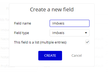

I’m trying the first option, where the data is linked but I’m doing something wrong and I have no idea of what it is.

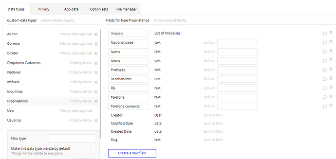

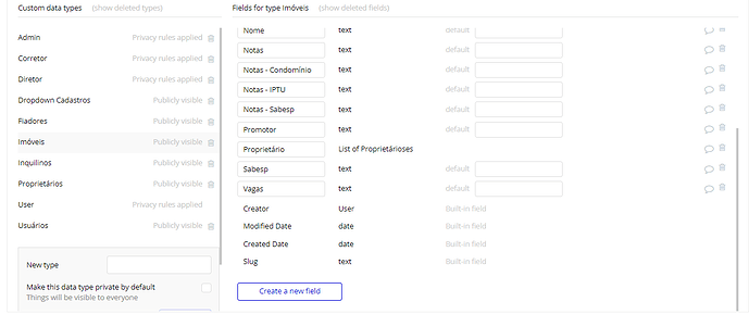

So basically I created 2 data types: Imóveis (properties) and Proprietários (property owners) and inside them I created multiple text fields and inside imóveis I set a list field searching at Proprietários, and somehow it managed to understand that the most important field for me is “nome” (name, in portuguese) and it works just fine.
Okay, I think I understand what you are saying, and I think I know what’s tripping you up. You are trying to manually add things to the list fields, and in one of them, you can type something like the name and find what you need, but in the other one, you can’t. If that’s what is happening, click this button and see if the data type that you can’t search has its primary field set to unique id.
If it does, change the primary field to another field, and then you should be able to type the values that are found in that field in order to add items to the list.
So, first, was it intentional to make the address and owner fields lists? If it wasn’t, you will have to delete those fields and add new fields that aren’t lists.
Next, can I assume the owner field is a text field and the content format of the input that is being used to populate that field is also text? If that is correct, the fact that the types match is why you aren’t having a problem there. That being said, what is the field type of the address field and what is the content format of the input you are using to populate the address field? I’m guessing there is a mismatch there.
By the way, if you click on the red text at the top of your editor that shows the number of issues you have, it will help you understand the reason the expression is red.

What I did there was basically what you told me to do at your first response (if I got that right):
I created an owners data type in which the name = text
I created a properties data type in which the adress = text
At owners data type, the adress field is a list with its field type being properties
At properties data type the owner field is a list with its field type being owners
But somehow it just works out for one of those (owners)
I’m wondering if I should register the adress first on another data type and then later just add stuff to it but that’d feel so much extra work, idk. The way it is now I’ve already registered an owner’s name and later I’m just registering an adress with all it’s properties, such as neighborhood, postal code, owner, etc… but somehow it doesn’t work so good what do you think it could possibly be?
