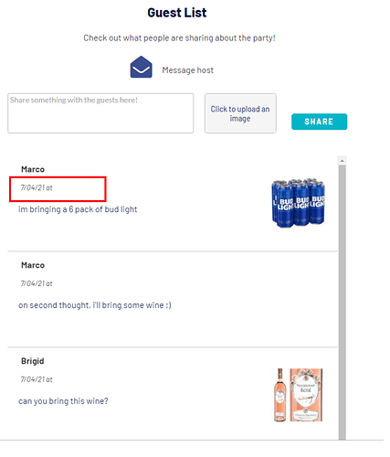

  1. On the Feed page I’m supposed to include the time a user posted to the feed. Time isnt part of the data types from what i can tell. Is there a way to show the time that the comment was posted?

  3. For this one, do Current cell's Feed's Creation Date again after “at”, add :formatted as, and for the Format type, select the option that only shows the time.

I am good on #3 but have a few other questions on 1 and 2.
