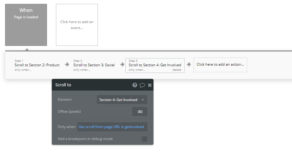

4. Set up a workflow on page load or after the page is fully loaded.
– The workflow trigger can be attached to when the page is loaded or after any other page load workflows.
–Use the action scroll to an element
– The element = where you want to scroll to.
– Have the action happen only when and use get data from page URL.
– The parameter name is whatever you have chosen in step 2.
– Add is and your section name.

5. Refine using offsets.

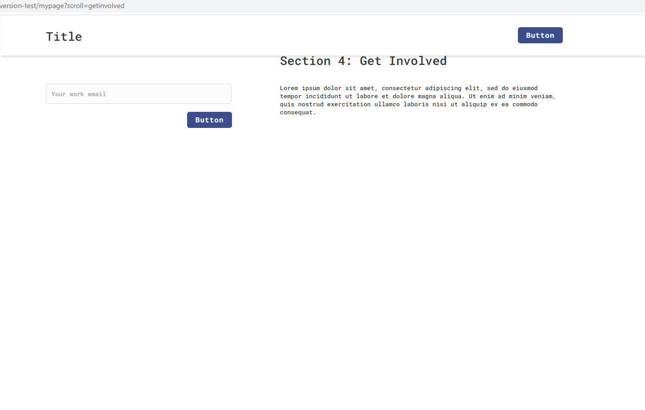

When I used ?scroll=getinvolved I got a result that doesn’t look very nice because I have a floating group as a header.
To make this look better use the offsets in your scroll to element workflow actions.
Because my header is 80px tall, I want to have my section appear 80px lower. To do this I’m going to tell Bubble I want it the page to scroll to 80px above the section, or -80.
If you wanted the section to appear higher then use positive numbers as offsets.
After adding this to each of my actions here is the result:
