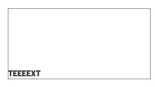

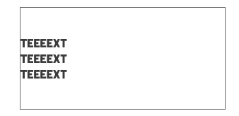

Align text at the bottom or TRUE center for a consistent, sexy UI
(Bottom align. pretty sexy, right?)
(True center, not Bubble’s silly vertical center. OH MAMA!)
I’ve seen this question come up time and time again, so let’s put it to rest. You’ll need a little CSS to accomplish this feat of beauty.
Your text elements are really <div> containers. Inside these divs there’s a content class.
Give the desired text element an HTML id. For this purpose, we’ll call it bottomtext and you’ll need to use Flexbox for this purpose. It seems to be the best and most supported practice.
Then on that page’s HTML header, add this bad boy:
#bottomtext {
  display: flex;
#bottomtext .content {
  display: inline-block;
  align-self: flex-end;
If you need it centered, just replace flex-end with center.
ps. don’t forget to surround your text inside <style> tags!
PEACE!

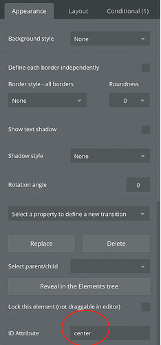

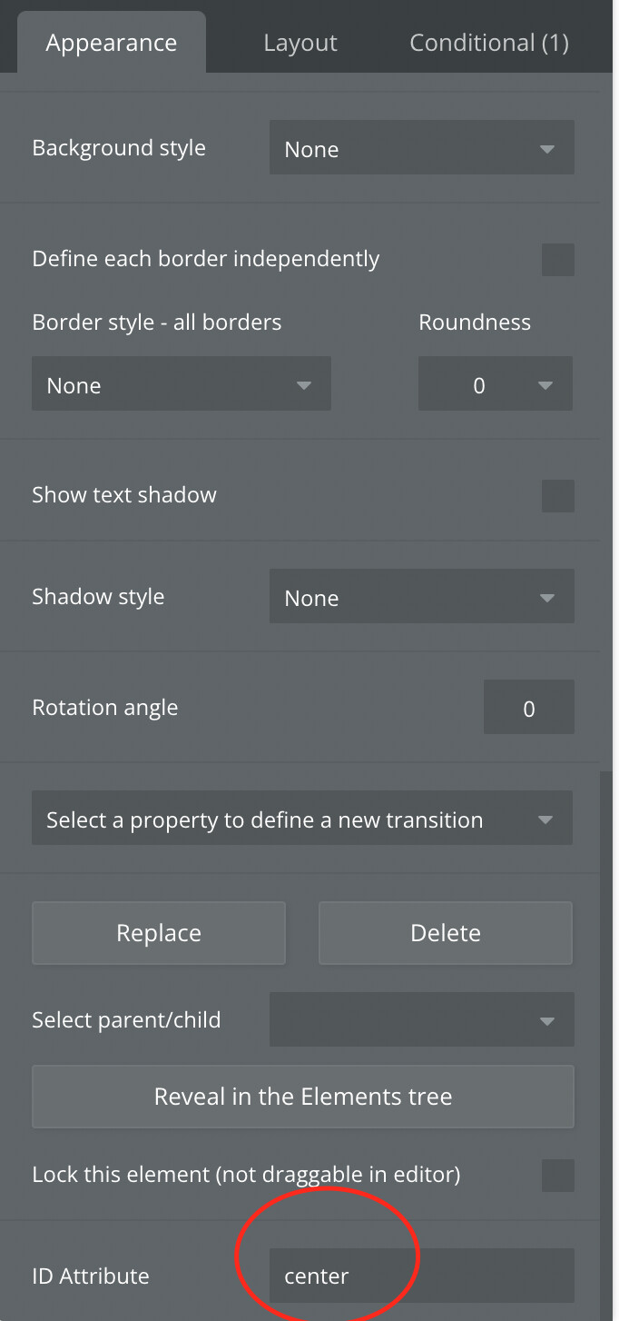

  1. Drop a HTML on the page.
  2. Put: <style> #center { display: flex; align-items: center; height: auto; } </style> inside the HTML (or in header, if it is a paid app plan).
  3. Give the #center to the text element ID that you need to be vertically centered (without the #).
  4. Done!
