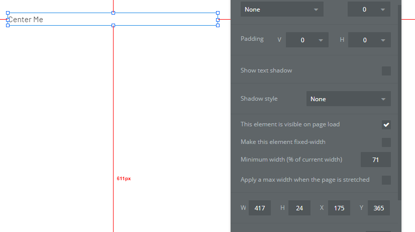

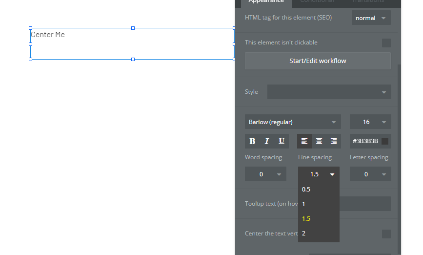

There is another way to ensure the centering inside a text element that I feel is much simpler.
    1. Create the text element
    1. Remove style (can save it later)
    1. Choose whatever font and font size you want
    1. Change line spacing to 1.5
Then change the element height to be the font size + 1/2 the font size - So 16 with 1.5 spacing would be 24 and the text will be perfectly centered in the element
I learned that tidbit from @gregoryjohn at buildcamp.io
Hi Mike,
The problem with that solution is that it breaks as soon as you use dynamic data with varying number of characters.
For a group to not expand if a text element inside it is not tall enough (in bubble speak) the text element has to already be the maximum height required for any length of text (to give it room to expand inside it’s own element) or be allowed to “cut off content”
Having the ability to center inside its own element is the functionality needed for that to work. And that piece is what’s currently missing in bubble.
