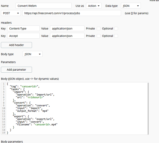

I am currently trying to get bubble to record video → send local file to a conversion api → send it back to bubble as a video file that is in .mp4

When the user has finished recording and the video upload to the bubble servers has complete (using the plugin here) i start the api using freeconvert.com sending the video
Then once the conversion has finished it sends me a webhook where i then grab the url from the completed “job” in freeconvert. Once I have got the job i grab the temporary url that freeconvert gives, and then use the plugin big file uploader to save the temporary video url to bubble database.
However, the file that is saved in step 4, seems to just be a application/octet-stream not actually an mp4 video file, and so i dont think it has the metadata that is needed for the whisper audio transcription.
The need for the conversion was because with the camera, it doesnt always put in the right metadata depending on browser. converting the file just on the website without apis made it work so i implemented it in the workflow.
