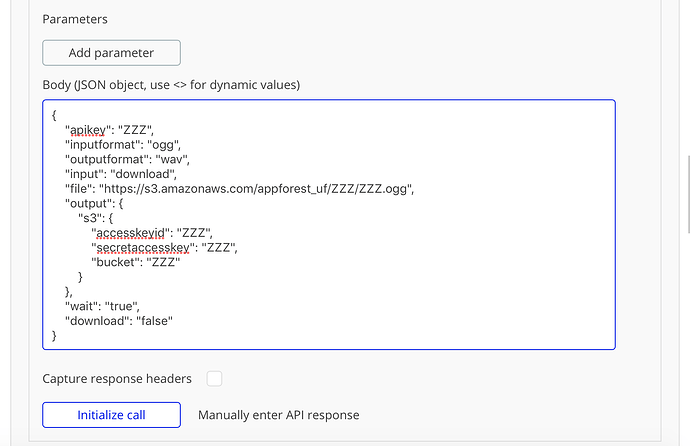

I’m trying to use the API from CloudConvert to convert a file from .ogg to .wav.
As I understand that we cannot get a file via API back and save it on Bubble’s s3, I’m saving it on my own s3 bucket.
This is my call:
“apikey”: “zzz”,
“inputformat”: “ogg”,
“outputformat”: “wav”,
“input”: “download”,
“file”: “https://s3.amazonaws.com/appforest_uf/zzz/audio90037081.ogg”,
“output”: {
“s3”: {
“accesskeyid”: “zzz”,
“secretaccesskey”: “zzz”,
“bucket”: “zzz”
“wait”: true,
“download”: false
In Postman the call is working properly, but Bubble has some strange behavoiur. I’m getting the error message “Cannot POST /download/DJdeQkvFHIPZWahYwCzj” BUT the process works and the converted file is saved in my own s3 correctly.
I would just need to a successfull API response to integrate it in my workflow and I just can’t figure out what to do.
Does anyone has a clue what I can do?
Thx!!

Here we go:
My Goal: Send a file from Bubble s3 to CloudConvert via API and let the conversion magic happen and afterwards save it on my own (= not Bubble) s3 bucket.
Here is the call in Postman:
Here is the response from Postman (plain text as the answer is to long to make a proper screenshot):

As you can see I get a response with " “message”: “Saved file to S3” ". This would be the outcome I would expect from Bubble as well.

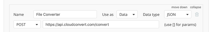

Here it the API connector in Bubble:
Here are the corresponding responses in Bubble:
1.) Wait true + download false:
Raw response for the API
{“error”:“Process already started. Please use GET requests to get the current status.”,“code”:400}
→ The file has nevertheless been converted and correctly saved in my own personal s3 bucket
2.) Wait false + download false:
3.) Wait true + download true:
Cannot POST /download/WFH0URKGm2ehIb6dzQCS
4.) Wait false + download true:
It’s really a mystery. It works perfetcly fine, but I get error responses. I just don’t know why (and of course why there are 2 different ones).
So if anyone has an idea about what’s wrong, I would be really thankful because I just can’t get through it… Thx!
Ahh, that is why our results were different – you are using the /convert endpoint for their “console”. In my test I used the process documented here which allows you to create a process which returns a url that is used in the second call. I have to run out right now, but take a look at that link and if you need, I can send you a sample set of calls.
Oh wow. I tried it earlier which this approach but it didn’t work out. Because of that I started using my own s3 bucket. And now it works with the 2 step flow. :open_mouth:
Thanks for pointing me into the right direction @mebeingken :smiley::+1:
Just in case someone wants to achieve the same some day:
I deleted the “download” key and it finally worked!
