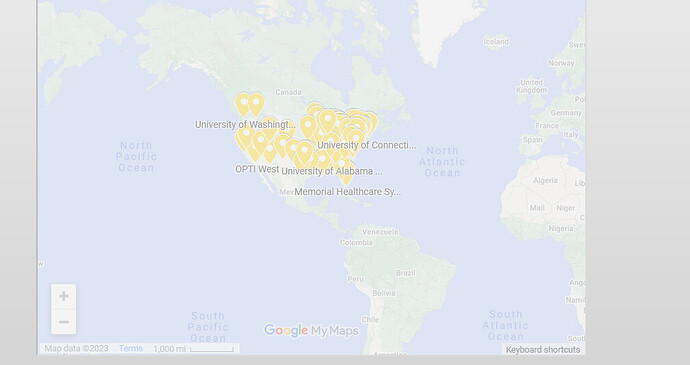

I am having a similar issue and cannot figure it out. My floating sidebar is not affected, but the main group has that gray overlying layer that won’t go away if I delete the affected group and undo the deletion.
I see you fixed the problem by deleting the pop-up. Would this mean I need to delete all 5 of my groups that are in this one page and redo them?
I’ve included a screenshot below of one of the five groups that are affected by the gray layer.
