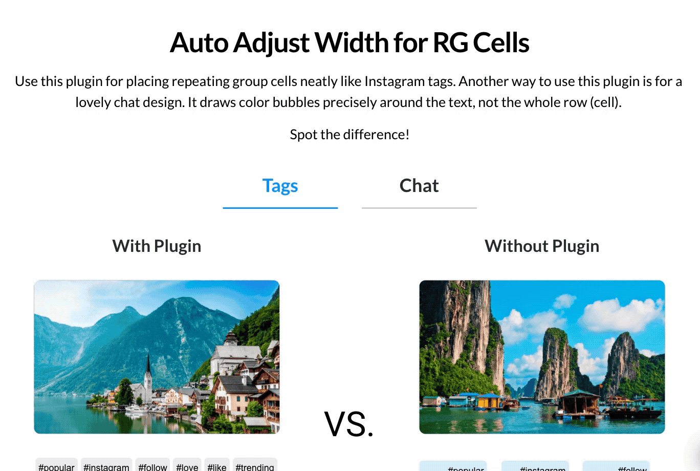

This plugin allows repeating group cells dynamically adjust their width to their content so that it looks neat and stylish. As an example you might want to use this for displaying tags or for message bubbles in chat. Simply set a plugin element on the page, set the RG Id into it and here you go.

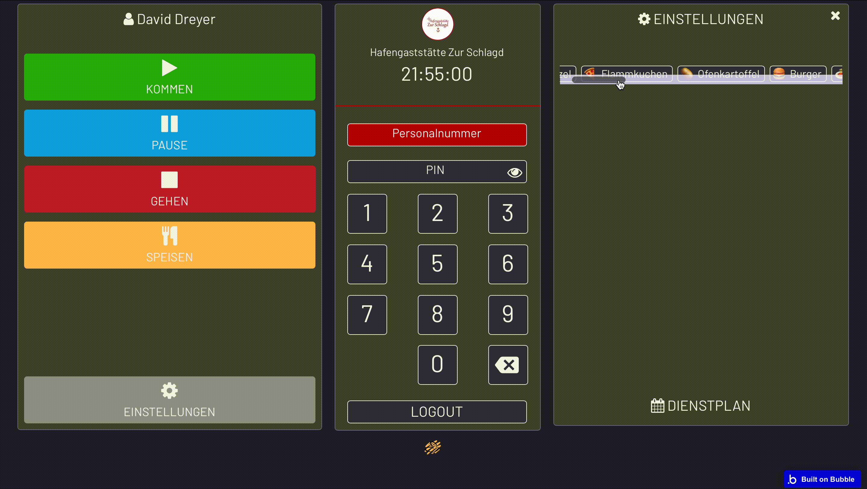

My second concern is that the plugin has problems when having a horizontal repeating group, because it adds white space at the end. You can see it here:
We will check how feasible it will be to add the requested feature to the future plugin update, thank you for suggesting it.
Unfortunately, this issue is related to the repeating group functionality on the Bubble platform.
In your case, the RG horizontal ordering should modify the width of the repeating groups, and the plugin is not able to do that, sorry for the inconvenience.
The plugin is designed to work and modify the height of the RG element and not the width. I’m afraid we can’t do much in this regard, sorry about that.
