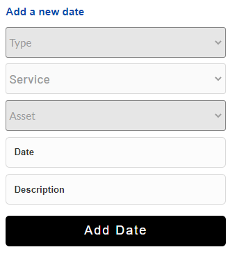

Step 1) creating a thing
Step 2) editing that thing using auto-binding

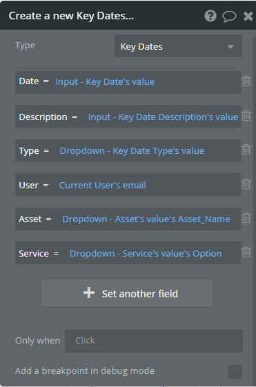

Inputs
Add thing

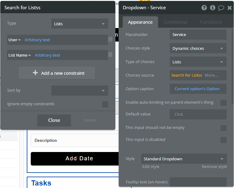

It works brilliantly, no issues. The Input Drop Down reads from a Type with filters, see screen shot - this one is important for my problem statement

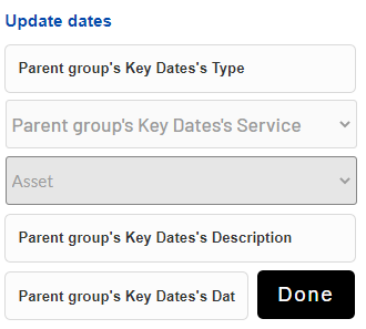

Display group and pass data from repeating group

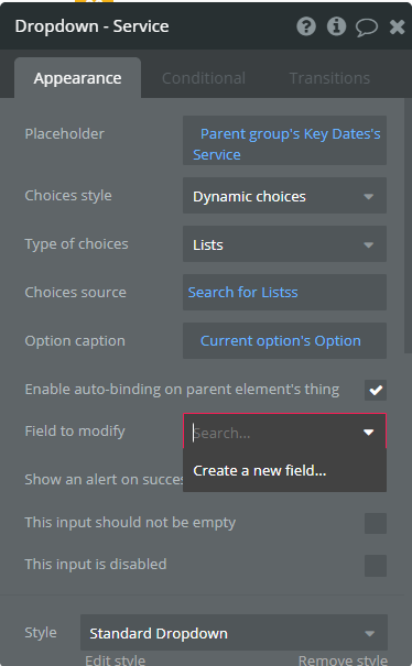

Group has these inputs - field in question is Service
As you can see no options are available to bind the data, if I drop back to static (I don’t want to) - the options become available

Thanks for detailing your problem!
My guess is that you are trying to auto-bind a field that is from a different datatype.
Please, if that is the case and you need that it works this way, what you could do instead of auto-binding is using the event “An input’s value is changed” for this dropdown:

A follow on, I think I’ve narrowed in on the issue, maybe. Wondering if you know:
Field I’m trying to bind to has a Field Type of “Number” - only fields with “Text” are available to auto-bind to in the drop down. How do I change the drop down to be a "Number " format?

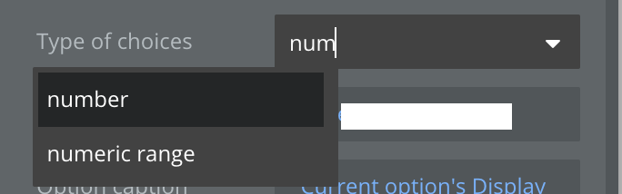

About the field type of number, I am sorry if I didn’t understand it right, but here you can change the dropdown type of choice to number:
Screen Shot 2021-09-09 at 08.38.10
The field you are trying to auto-binding also needs to be the type of number and it needs to enabled in the privacy rules.
Please, let me know if it helps!
Thanks,
Mateus
Mateus,
I knew the answer was staring me in the face! Thanks, I’ve fixed it for dynamic choices.
