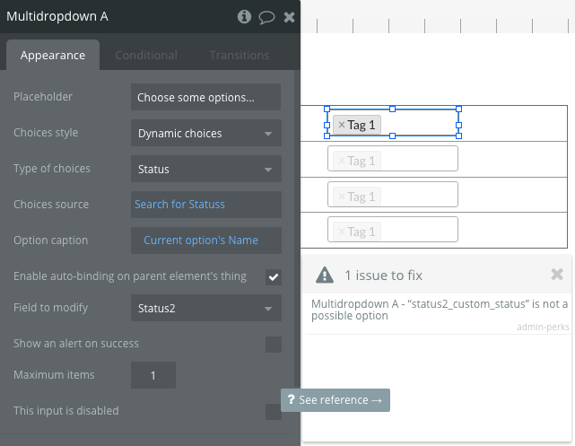

I think the multi select element let’s you modify such field but can you test?
Seems not possible or I don’t know how :frowning:
Something weird just happened. Now I’m able with the Single Dropdown. Have you pushed anything?
@emmanuel whatever you have done you are the man.
I can confirm that now auto-binding works with “Lists of” :slight_smile:

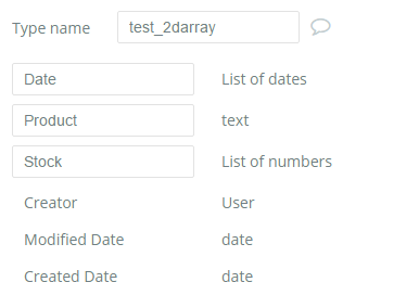

@JonL Not working for me. Can you share a screenshot.
I have a list of numbers but when I configure an input field to autobind with it - the only content format available is text.
See screenshot:

@pranjal This isn’t going to work for a list field. It’s meant to autobind 1 value. It’s better to do this in a workflow and use the “set list” modifier to update (replace) a list. You could also try the multitag drop down element (plugin), but I haven’t tried with content format as numbers (only Things).
