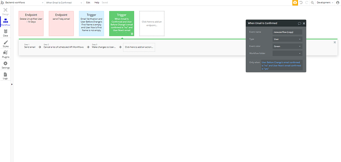

Thank you for your response. Here is an image of the Trigger that “listens” for the change to email confirmed is yes.

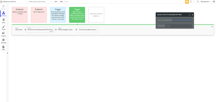

It’s three images, two are me highlighting the actual cancel steps (I store the scheduled API id in a field list under the user so I can reference it here for the cancel)
I have the scheduled API workflows set for a time in the future, so I’m not sure if that condition you mentioned still applies?

I understand how you have set thing using Trigger WF. I think you may consider this an issue and submit a ticket to Bubble.
But for what I suggest is to add the filter to Endpoint in red (because I guess they are the two scheduled workflow). Check if the user you want to do something is confirmed or not. If not, let the scheduled WF process.
