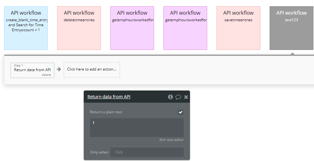

Sorry, I guess I thought you could see the backend stuff in my project, but here are some screen shots. It’s very simple, not creating or updating any Things at all, just trying to return the number 1 because I’m seeing this strange behavior (which is why I created this test).
It should just return the number 1, but it’s incrementing something…I don’t know what or how.
Sorry, other images wouldn’t upload for some reason, here they are…
Workflow4
I’m not sure but the backend workflow return data with no subsequent steps wouldn’t allow you on its own to visualize a number on a page.
I don’t think you can grab the result of the api call itself from the page…at least I’ve never attempted it and could be wrong, because you do have a dynamic expression taking the result to display it. But I don’t see how a backend workflow action would be available on the page from which it is scheduled.
As @boston85719 pointed out, there’s no way to get data from the backend workflow back into the page, unless it’s being stored somewhere in the database.
In your on-page workflow you’re using Display Data with the data being the results of step 1.
That will simply give you the Scheduled API Workflow’s ID (i.e. 967), which is what you’re seeing on your page - each time you run it again to schedule another workflow you’ll get the new workflow ID.
