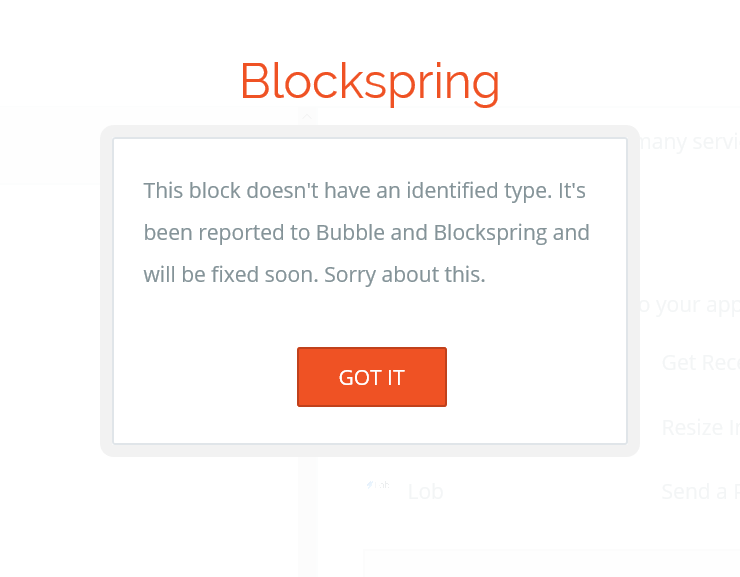

Everything seems to work except the one I need… Diffbot Hopefully it will by next week.
Which call specifically? Getting the types returned programmatically is actually a bit tricky, so we need to see with Blockspring what we they can do.
I get the error message for all the Diffbot calls.
I’ll check with Blockspring, we can’t do anything directly here, so i’ll see with them.
Which blocks are you interested in? I tried 3 and they all worked…
Extract discussions from webpages and Automatically extract content from webpages.
I just tried it again and get the following:
Here is link where I get the message: ylp-bus | Bubble Editor
yeah, that one returns an empty object from BS. I’ll ask them. some others work well though.

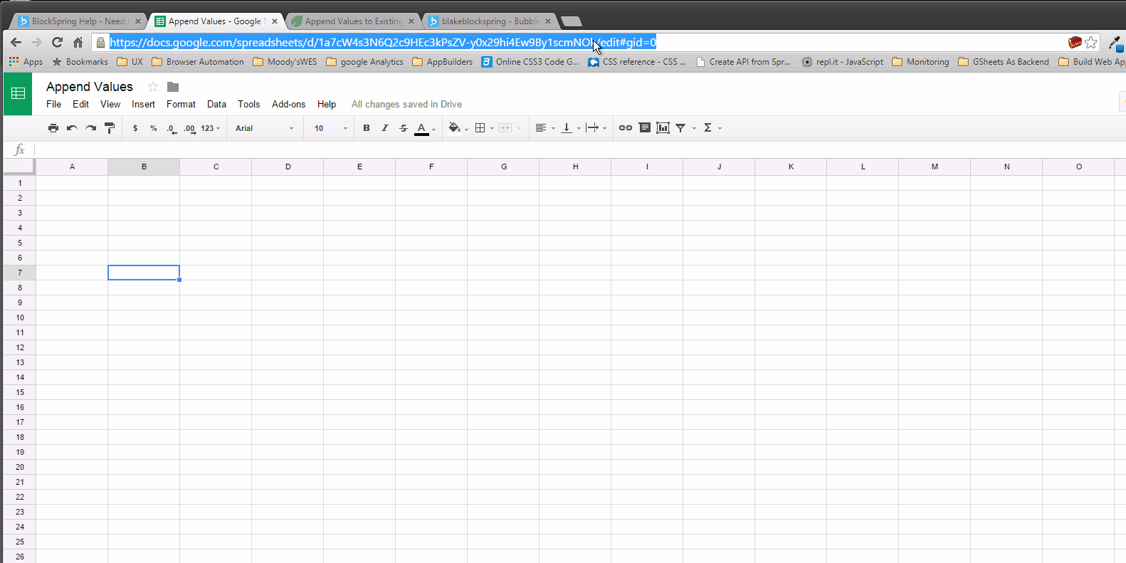

Hopefully you’re still watching this thread @emmanuel… I’m now trying to use the Google Sheet - Append Values to Existing Google Spreadsheet BlockSpring. I try it out on BlockSpring with the same FileID and it works great, but when I run it on Bubble the page kicks back an error, saying:
“Sorry, we ran into a temporary bug and can’t complete your request. We’ll fix it as soon as we can; please try again in a bit!”
Here’s the page with the blockspring in it. https://bubble.io/site/blakeblockspring/version-test/index?debug_mode=true
Any chance there’s something I’m doing wrong or that can be done on the bubble side?

It works in the setup, in the blockspring window pop up. Also works on blockspring (seen in gif). And when I use the debugger you can see that the file id and value being passed are right, but then still get the error. (the gif below also shows running it in the debugger.)
