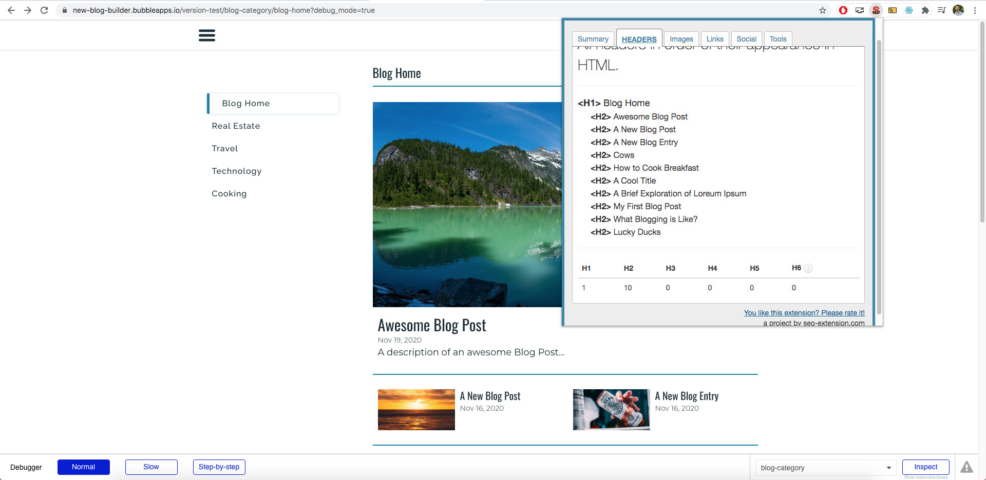

The reason you are probably not seeing it in a test that you are performing, and the same reason why I don’t either using SEO tools is because the template is basically on a “Free” plan, and free plans in Bubble do not support or provide for SEO functions.
But this seems strange to me, so I will submit a Bug Report to Bubble concerning this subject since, while I am in the debug_mode to view the inspector tool, I can also use an SEO tool extension on browser, which normally picks up the Header tags regardless of the plan the app is on…in this instance this is not the case
Even though the inspector tools shows the H1 the SEO tool extension shows none. I’ve had issues in the past with Bubble regarding the page description and title not coming back properly for SEO and after significant teeth pulling they acknowledge the Bug and rectified it. This might be similar.
Looking closer at this as well, I checked the text element for H3 and the option for Header Tag is not available on the text element, not on the text element itself, and not in the Style of it either. There must be some Bug, and might be associated with the version of Bubble the template is on.

Support came back and informed me my settings for enabling header tags was not checked. Very strange as it is checked by default when starting a new app, and the elements had them set already so when checked again they came back.
