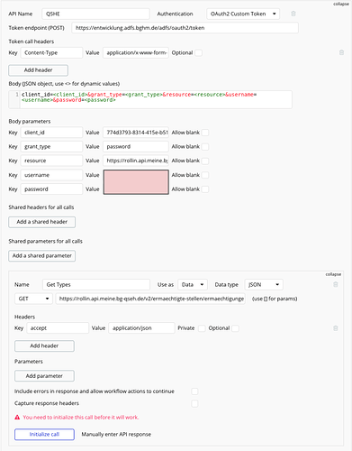

Doing the same in Bubbles API:

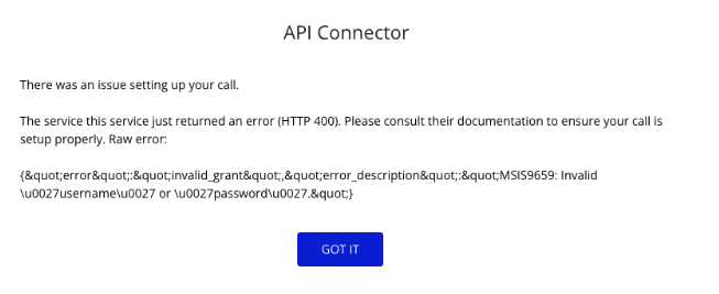

The result I am getting:

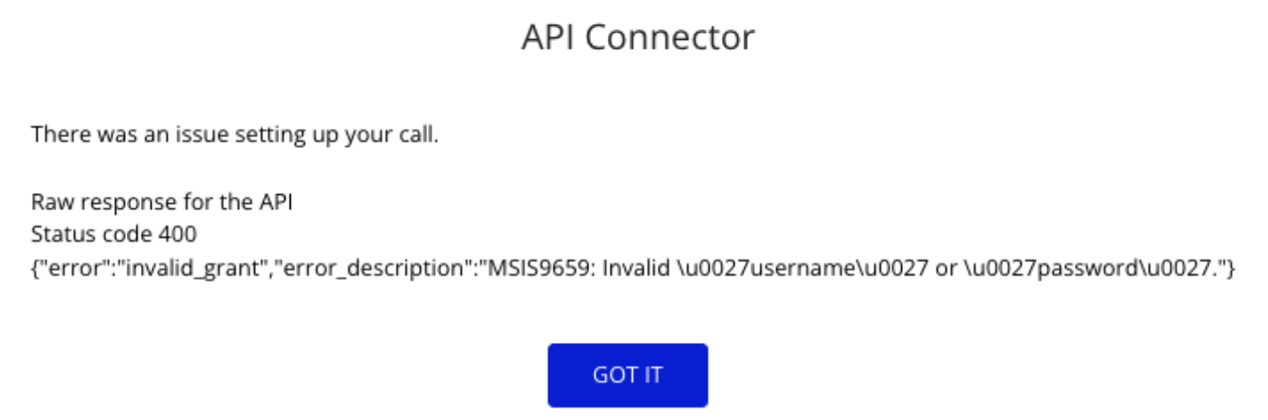

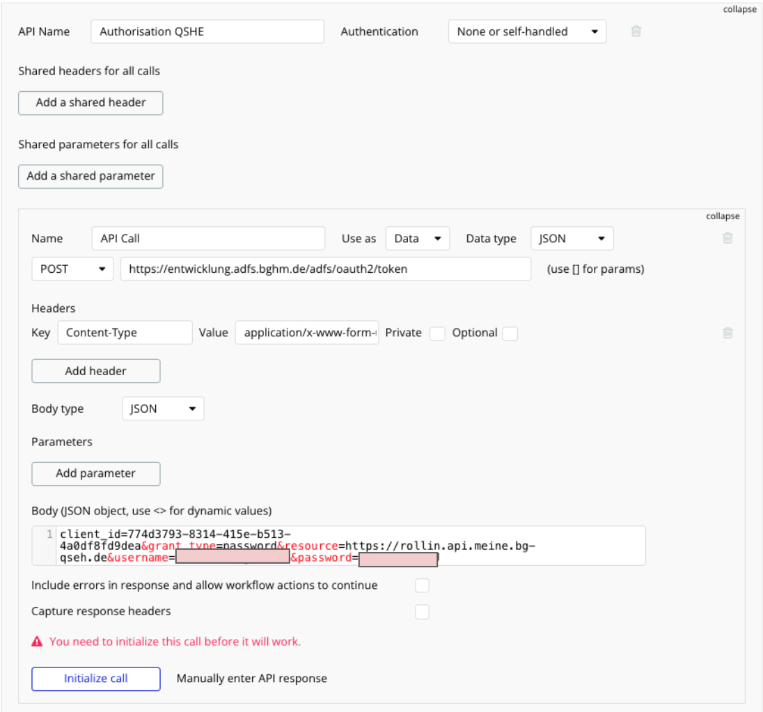

And just btw, the same happens if I do the authorisation as a separate call:
Creates the same result
