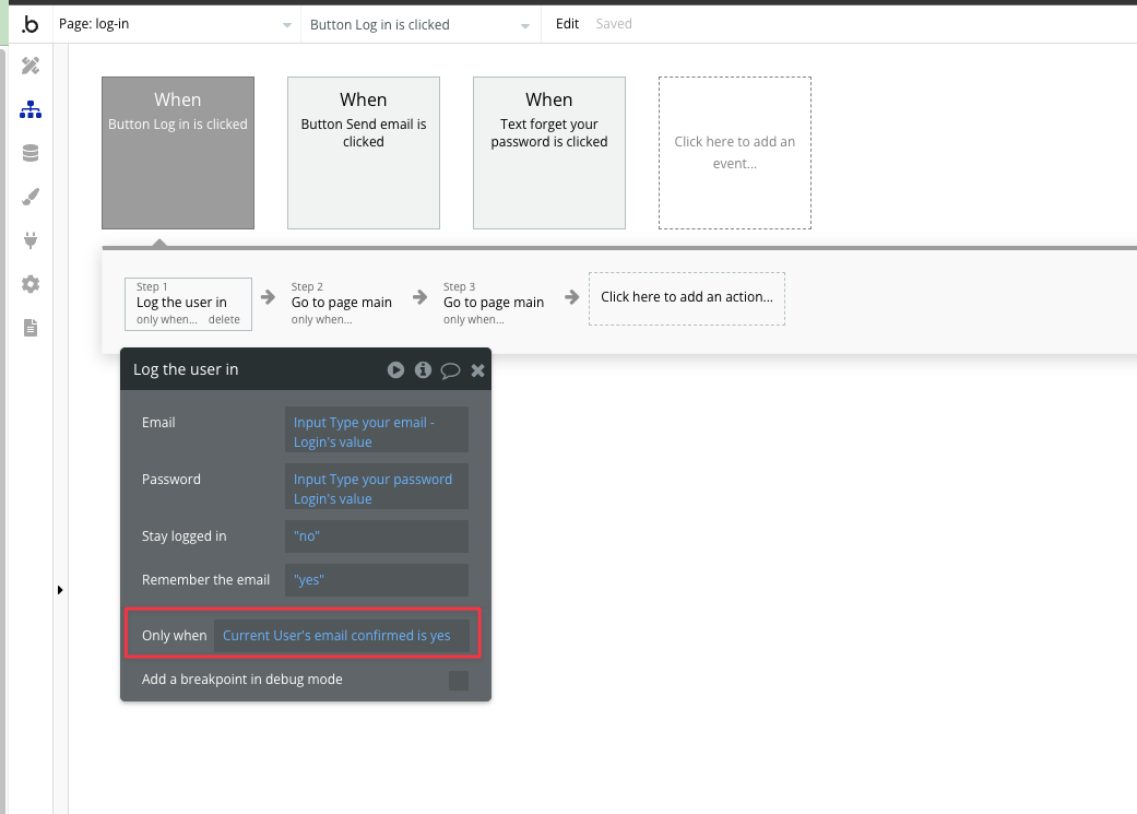

I recently tried to publish my first Bubble app but encountered an unusual problem. In some cases, Bubble doesn’t seem to verify the user’s email and password. For example, a user can enter any email and password and access the app, although they’re not actually logged in.
I’ve included a video recording below to demonstrate this issue. you can see that Bubble doesn’t check the user’s email and password, allowing them to enter the app.
I have spent 4 hours on this and I don’t see any setting problems in my workflow. Does anyone know what is wrong?

I checked several times again, and now it seems that Bubble doesn’t verify the email or password at all. I upload a new video below.
Hi W, did you use the debugger to see what is happening?
Finally, I found the reason. The below setting makes the error happen.
My original idea was that only the users who clicked the validating email were allowed to log in. But it turns out to let the un-log-in users go to the main page…

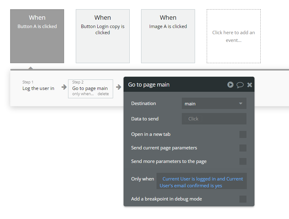

It might be smart to add a condition “Only when Current User is logged in” to the ‘Go to page main’ steps (since it seems you only want logged in users visiting page main) in your login flow.
Additionally you can show an alert to remind them to confirm their email.

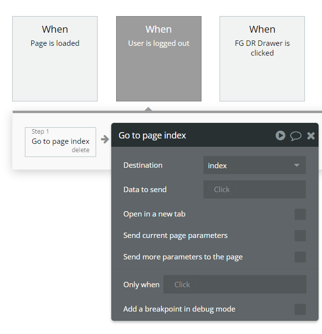

And add an event ‘When User is Logged Out’ with an action ‘Navigate to page index (or the page you want users who are not logged in to go)’ on page Main. This will send logged out users away.
Hope it helps!
