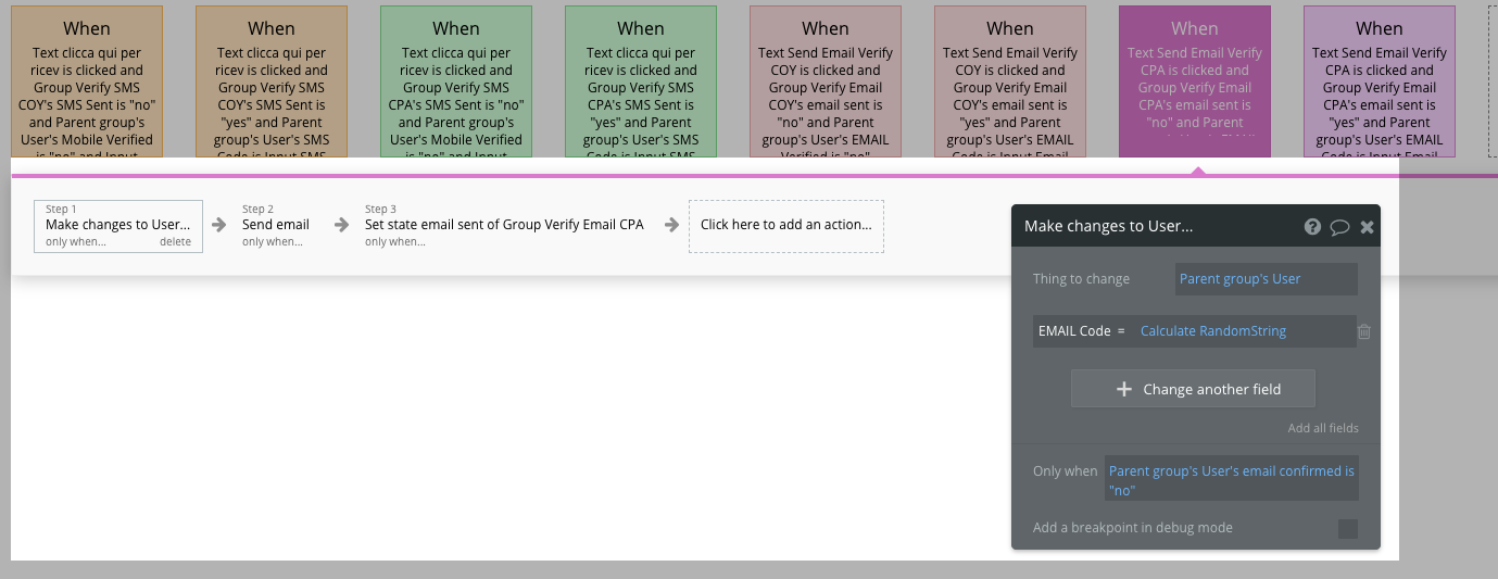

  1. when the text underlined (click here to get your email verification code) is clicked, create a workflow (I have used some status for better management of the various conditions) with the following actions :
3.1) calculate a random string and save it in the user field EMAIL CODE
3.2) send and email to the user with the EMAIL CODE printed in the body
3.3) in the front end change the text in the box to “input here your email code” and the link text to “click here confirm the email verification code”
