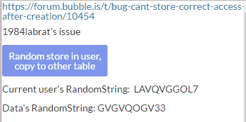

Here is an example, showing @1984labrat’s problem:
(Links removed)
Screen capture:
This is fixed
