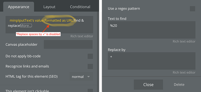

Solution / Workaround
  • The first thing to try is simply disabling the “Replace spaces by +” setting.
    This will encode spaces as %20, which will work in many (probably most) contexts and with most servers (but will result in a larger and less readable encoded string).
  • If you do need (or want) spaces encoded as + characters, then make sure “Replace spaces by +” is disabled (as above), and just append a :find & replace operator to the expression, replacing all occurrences of %20 with + as shown in the screenshot below.
