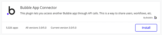

Have you tried working on two apps and just linking the databases together? That should help. Especially since you have 100+ pages. I think that is what I would do if need be. Try to separate parts of the app into 2 apps. You can always link back and forth between the two fairly easily with links as well. Then more easily you can have 2 developers at the same time.
You can add one of them as, for example, app.domain.com for one of them. Share the same main domain.
Just for reference, this is what I would do.
How does this scale if you want 4 or 5 or 10 developers? There is no environment to allow you to have different people working on different pages. Breaking up into sub-apps so you can develop it seems a bit against the nature of building a straightforward SAAS app. So if you want 5 developers, 5 sub-apps? Also the cost of sub apps while developing before you even get users is more expensive I believe?

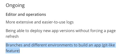

Just to give you a little hope…
“Being able to deploy new app versions without forcing a page refresh”
Maybe this will solve the problem.
I like the sound of that. Essentially instead of application level refresh, if two people were working on the same page, I could see being locked out. Let’s hope this is coming soon and as hoped!

It’s on the roadmap by the way.
Not quite, I believe that point on the roadmap is more like development version, then testing, then staging, then live. What people are talking about here is multiple people working on the same time on, say, development version.
