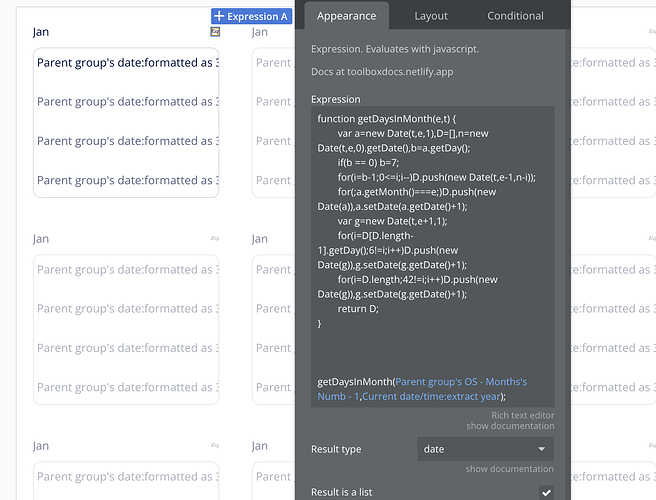

  3. In each cell you create the necessary UI and you add the Expression Element from the Toolbox plugin. In that expression you would put the following code first, then the dynamic expressions separated by a comma, and then the “);” at the end. To save you time, here’s the first part of the code.
function getDaysInMonth(e,t) {
        var a=new Date(t,e,1),D=[],n=new Date(t,e,0).getDate(),b=a.getDay();
        if(b == 0) b=7;
	for(i=b-1;0<=i;i--)D.push(new Date(t,e-1,n-i));
	for(;a.getMonth()===e;)D.push(new Date(a)),a.setDate(a.getDate()+1);
	var g=new Date(t,e+1,1);
	for(i=D[D.length-1].getDay();6!=i;i++)D.push(new Date(g)),g.setDate(g.getDate()+1);
	for(i=D.length;42!=i;i++)D.push(new Date(g)),g.setDate(g.getDate()+1);
	return D;
getDaysInMonth(
See image:

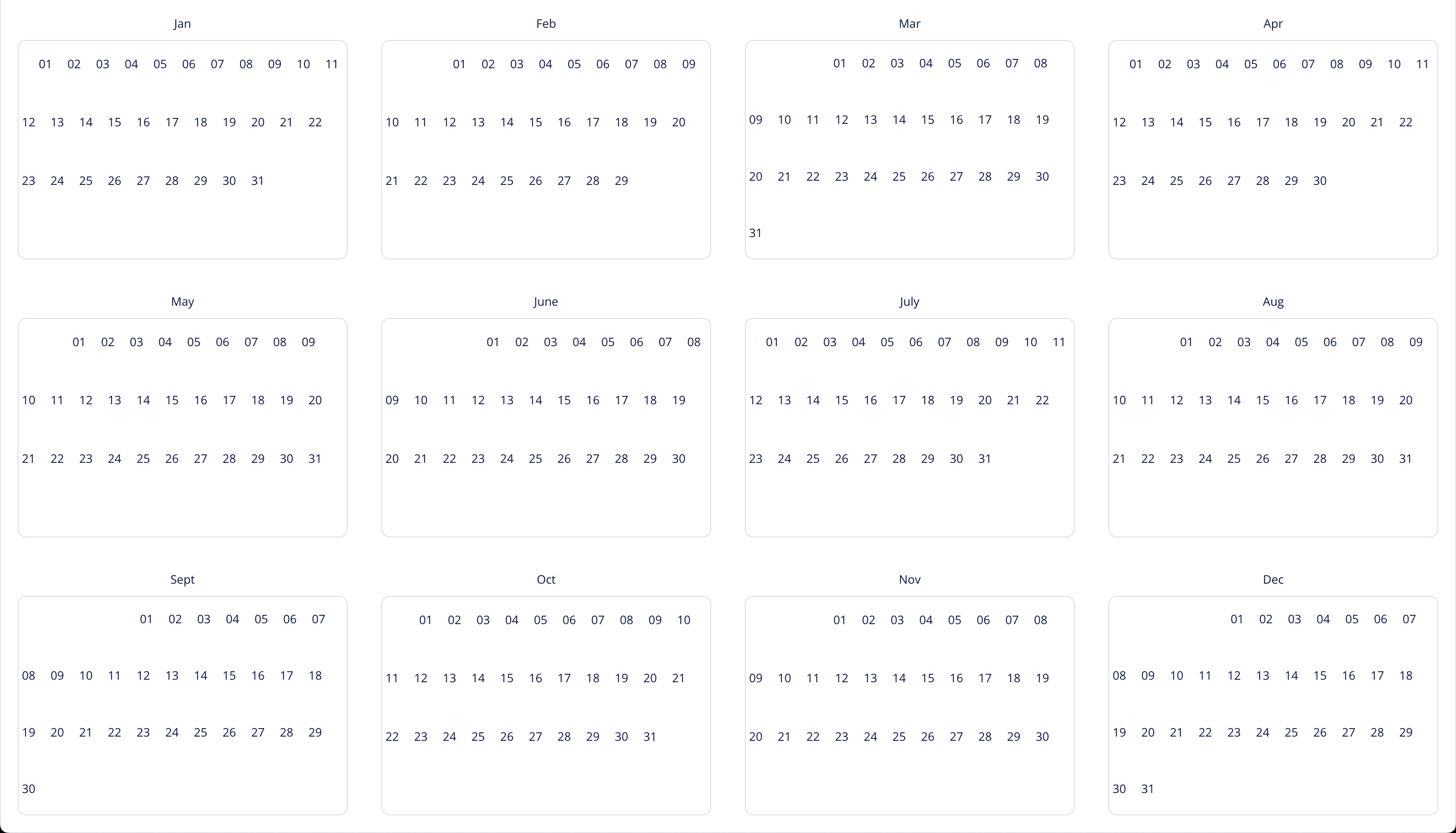

Here’s the finished result:
Since you’ve been Bubbling since 2017, I’m sure you can figure the rest out. :wink:
