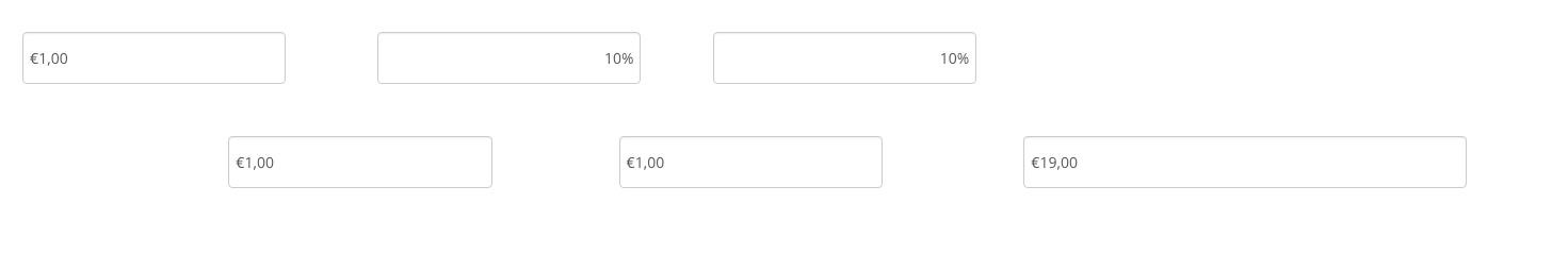

I´ve a page where I put the following calculations based on the price 1, tax 1 and tax 2. So you type the price, tax 1 and tax 2.
Then I´ve fields below that calculates the tax 1 cuota which is “price * tax 1” and tax 2 cuota which is “price * tax 2”, then the total which is “price + tax 1 cuota - tax 2 cuota” and I´m getting weird results.
For example: price = 1, tax 1 = 10 and tax 2 = 10. The app calculates the total = 19 € and it should be just 1 €
Here´s an screenshot.

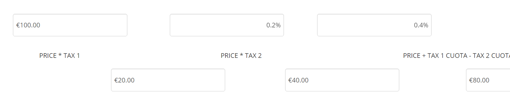

Thanks but the when inserting 20% in the input field and making the calculation, it´s interpreted in other app that we have as 0,2.
this is what I see;
Yeah that´s another problem that we´ve with percentage. We´re only getting this issue in that app so I don´t really know what to do.
