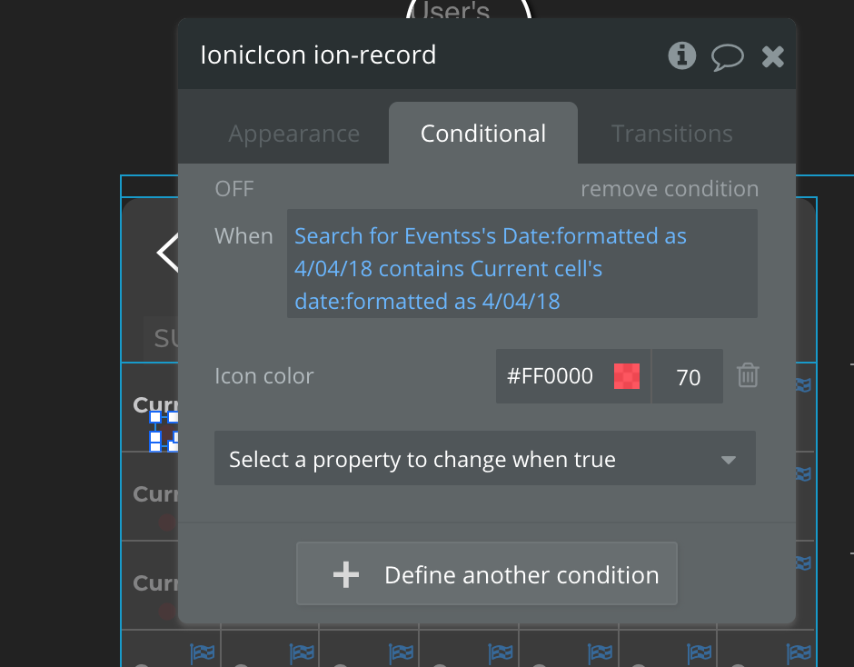

I was able set up the calendar but ut shows the icon in every cell. I have ‘events’ data type set up with date field and I have few entries to show but I can’t figure out the condition for this.
I figured this out with this condition format
