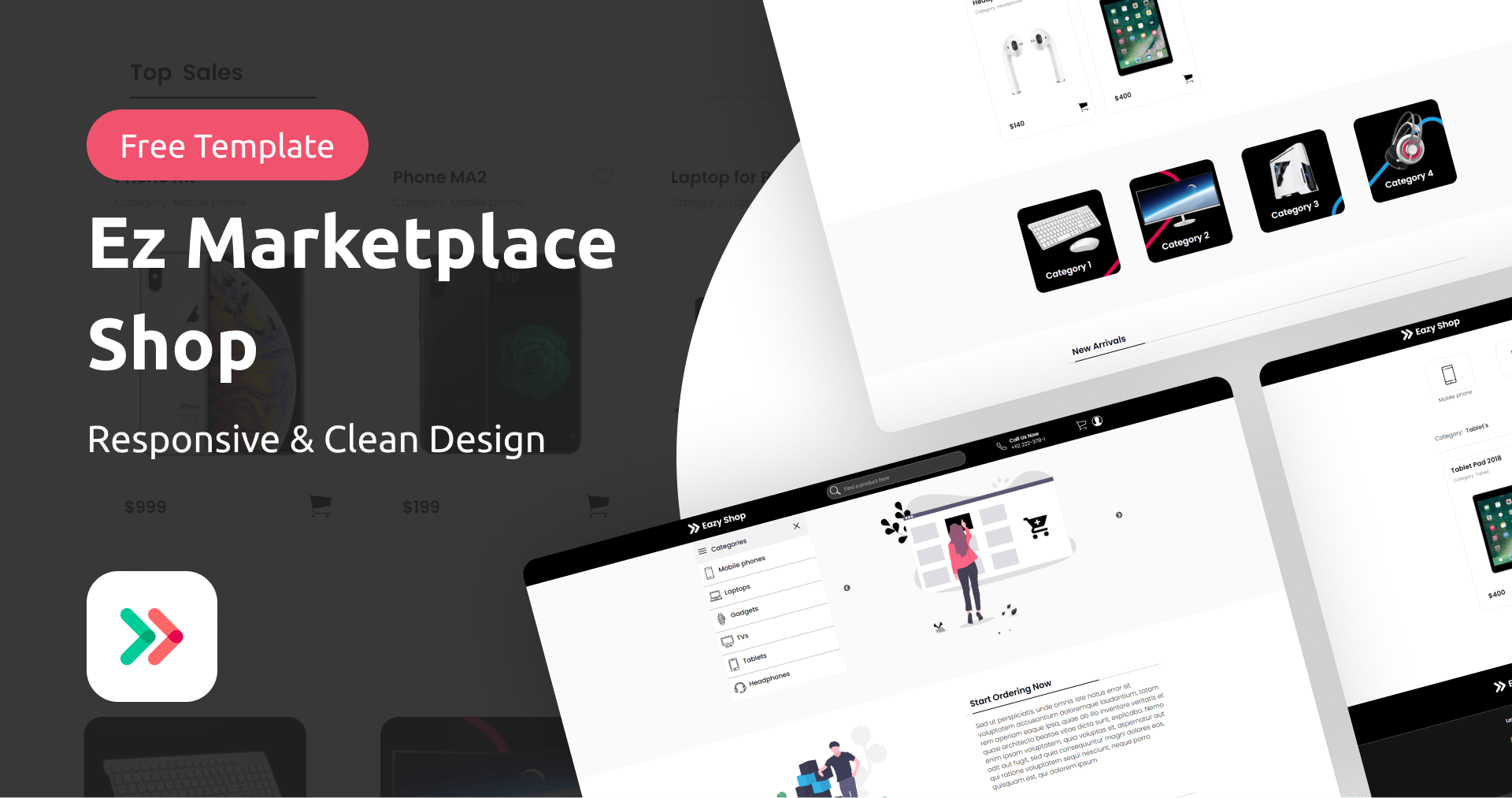

Can you recommend a mobile marketplace template, friends.
Start with a free one as this is a good way to learn the concepts (provided that you follow and agree with how the author approached the build).
This one seems pretty interesting
Thank you, but I still have question marks. I think the bubble will be enough because I want to make my app as a mobile app.
