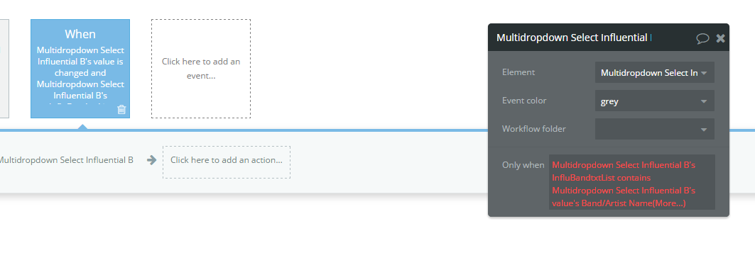

On the first page (listed above) I’m able to update the repeating video group by selecting various options in realtime. In the other page, I’m trying to do the same, but I can’t get the workflow to work.
Here’s the part of the work flow on the working page (first one, above)

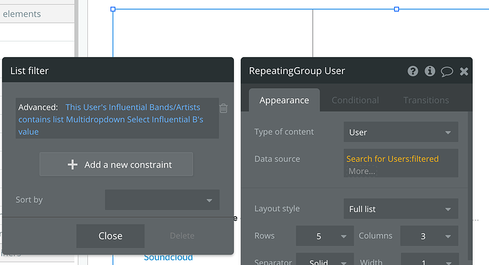

Hi Jason I think this is different from your other app because in the new app you’re using the multiselect dropdown, instead of a repeating group of clickable texts which sets a custom state list. Here, I don’t think you’re able to use the custom state “:plus item” function, because the workflow is “When the multidropdown input is changed” instead of when “This text [inside a repeating group] is clicked”.
However, I don’t think you need the custom state list here because the multidropdown generates the list of Bands for you. Instead of adjusting the workflow, I just changed the repeating group filter to have the User’s list of influential bands contain the Multiselect dropdown list value, instead of a custom state list:
*Note: this expression means that the Users must contain all of the Influential bands in the Multiselect dropdown, not just one of them. For example, if the User selects Opeth and Porcupine Tree, only the Users with Opeth and Porcupine Tree in their list will be displayed in the results.

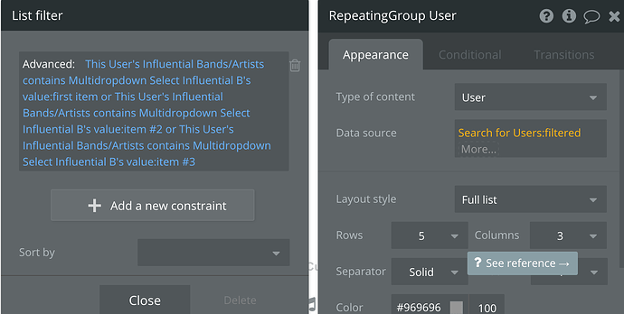

If you placed a limit such as ‘Select Three Bands’ (change the Maximum Items value from 7 to 3), you could change the filtered expression to:
This way, bands containing any of the three search terms will be displayed in the results (not the entire list).

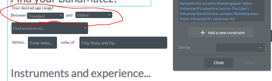

Haha, now I need to figure out how to filter based on the age range. I’ve tried a few different things and nothing seems to work.
Currently I have a dropdown for the youngest and another one for the oldest, then I want to use that age range to filter against the Age of the User. Seems like pretty easy thing, but I can’t figure it out lol.

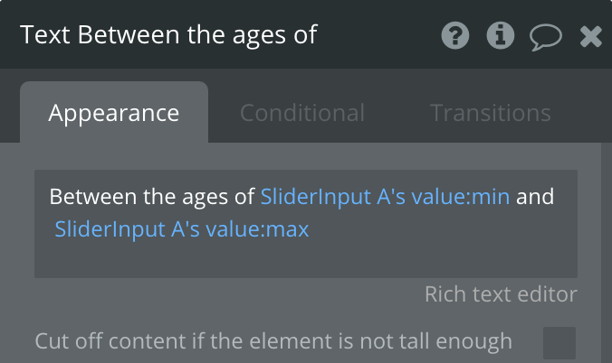

Ohh right, the values have to be displayed using a text element. You could put this in the “Between the ages of SliderInput’svalue:min and SliderInput’svalue:max” [Slider Input].
