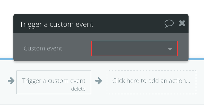

I think you’re actually after custom events. At the end of Workflow 1 add “trigger a custom event” Select the custom event (workflow 2) which can have its own conditions.

You just create three custom workflows. The first workflow checks the first condition and calls workflow two and three. They check condition two and three, respectively.
In that way you can avoid duplicating the checks and you just have to call workflow one to execute the action.
