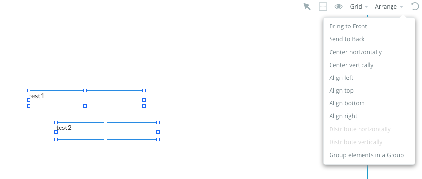

The option to center an item vertically within it’s parent element would be amazing. From what I can tell currently the only option is “Center relative to parent”, but that just centers the item horizontally.
2nd this.
Yes that’s an easy one, we’ll add that shortly.
Awesome! Thanks for the quick response.
It’s pushed
Awesome! Thank you!

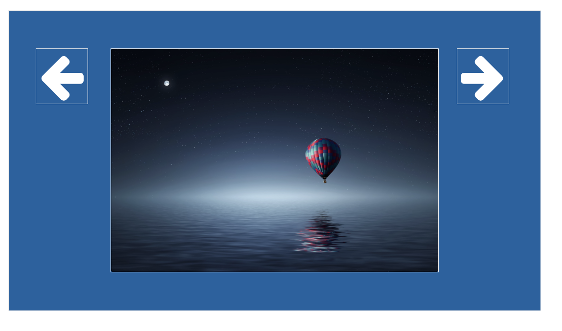

Centered Horizontally - equal space on left and right of image that is contained within the blue group.

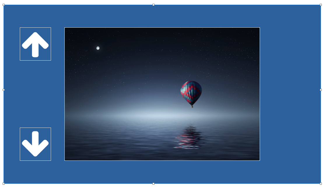

Centered Vertically - equal space on top and bottom of image that is contained within the blue group.
Thanks again!

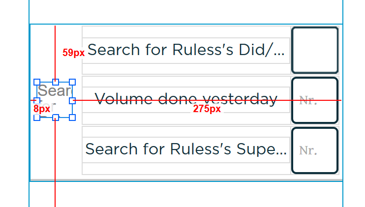

Well this Thread is a golden oldie. I actually came here for dynamic vertical centering for an element within a group, meaning when the groups on the right are hidden the element still searches the verical center point:
Can this be done without adding empty groups around the element?

Fro extra information: To the right you see multiple groups that will be shown or hidden depending on choices of the user and the parent group of all elements you see here will change it size accordingly. I want the  ‘Search’ square you see to the left to always find the vertical center of this parent group. Currently I achieve this by surrounding the search square with empty groups and then hiding/showing them, but there probably is a more elegant way to achieve this.
Any ideas?
