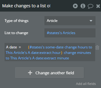

I can see how to use the element action now and Ive saved the list of new dates as a state, I cant see how to “make changes to a list of things” and replace all the old dates with the new ones though.
Screenshot 2024-07-09 at 6.12.40 pm
Ah I misunderstood your original post a bit. I thought you wanted to change the field values of a list of dates of a Thing. If all you’re looking to do is change a single date but keep the original time all you have to do is write the expression as such:
New date, change hour to original date extract hour, change minute to original date extract minute.

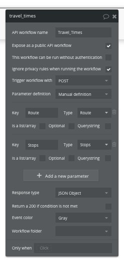

Hey mate looks like this is my best option, im having trouble getting the workflow to work. My plan is to use the api backend workflow and like you said trigger it to run on the list. I cant get the workflow logic to allow me to change date too though.
Screenshot 2024-07-10 at 8.46.00 am
So Ive created a backend workflow which should use 2 states which are numbers to replace first the day, then the month of the dates without the time, however I cant workout why it wont run. Screenshots attached- How can i debug or test backend workflows like the step by step feature to diagnose the problem? Not sure where ive gone wrong. Ive tested the workfow logic on the page for a singular date and its worked, just don’t know where its going wrong when using the backend api which i need to use because I need it to run on a list of things.

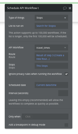

I updated the plugin to include backend action. So you can create an API workflow that will take the current list of dates of the stop then change it all to a new date. Then just use the Schedule API WF on a list action, client side.
Try it out and I hope that helps. Look out for timezone differences.
Here’s a sample Schedule API WF on a list action. As you can see, make sure to add the necessary parameters.
Here’s the API WF
Here’s the plugin action in the API WF

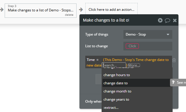

Man I hate to make things difficult, but I have a list of things (stops) and each different thing has a date. So its not that each stop has a list of dates rather I have a list of stops who all have dates. With that being said I tried to use the plugin and then make changes to a thing as per my screenshot. I need to make changes to a list of stops, each stopss date.
Screenshot 2024-07-11 at 3.19.38 pm
So your Stop’s Time field is a single date value?
EDIT: If it is then you should have no issue accessing the change to date/hour/minute expressions and you wouldn’t need the plugin.
That has worked thank-yuou very much- your plugin has other uses in my app.
