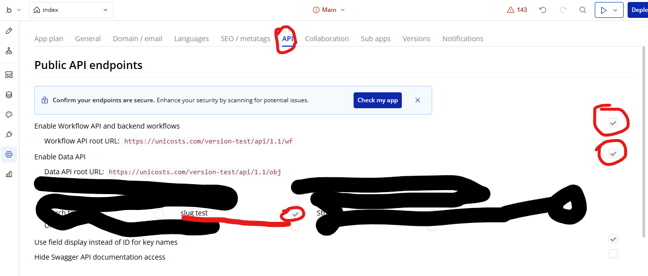

  2. Go to Setting → API and ensure these boxes are ticket, as well as the data type you would like to work on

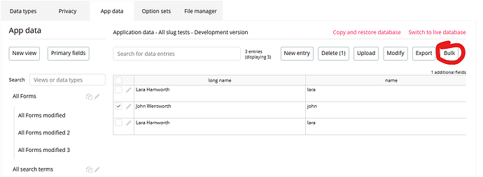

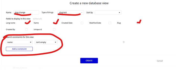

  5. Return to your data. If you would like to run this workflow on only certain things, and not the whole data set, click ‘New View’ and then set up your conditions.

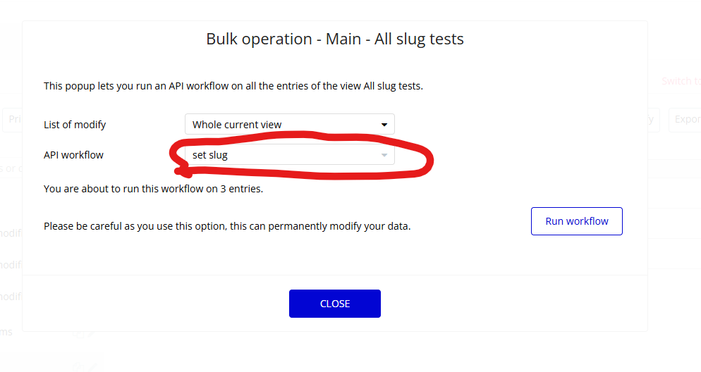

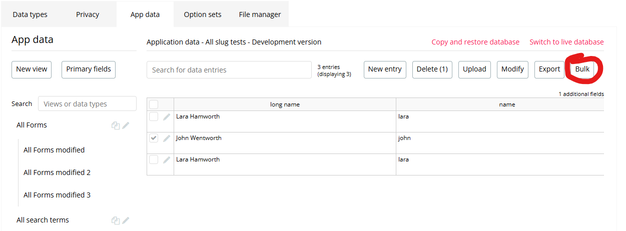

  6. Click ‘bulk’.

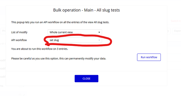

  7. Select your API workflow from the drop-down and click ‘run workflow’.
