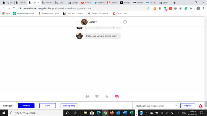

I made a backup copy of the Zeroqode Daty template (Tinder clone), and as you can see in the picture, there is a chat bar:

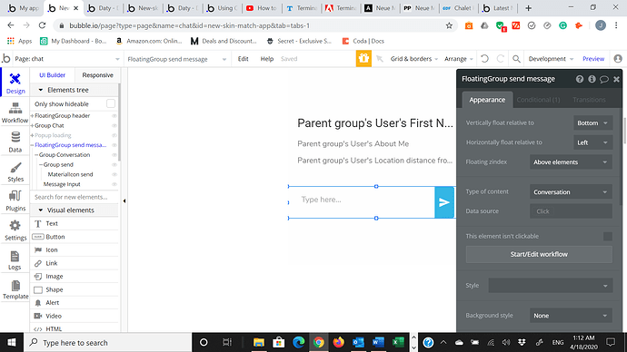

However, in my working copy, I somehow managed to delete the chat bar:

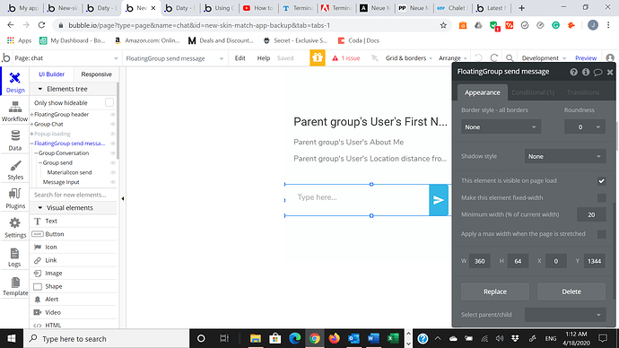

I’m not sure at all what I did, but as you can see from the Design tab from both apps (both backup and working copy), everything looks virtually identical:
Backup…
Working copy…

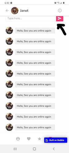

Not completely sure what to make of it, but I did notice that the chat bar appeared when accessing the app from my mobile device:
