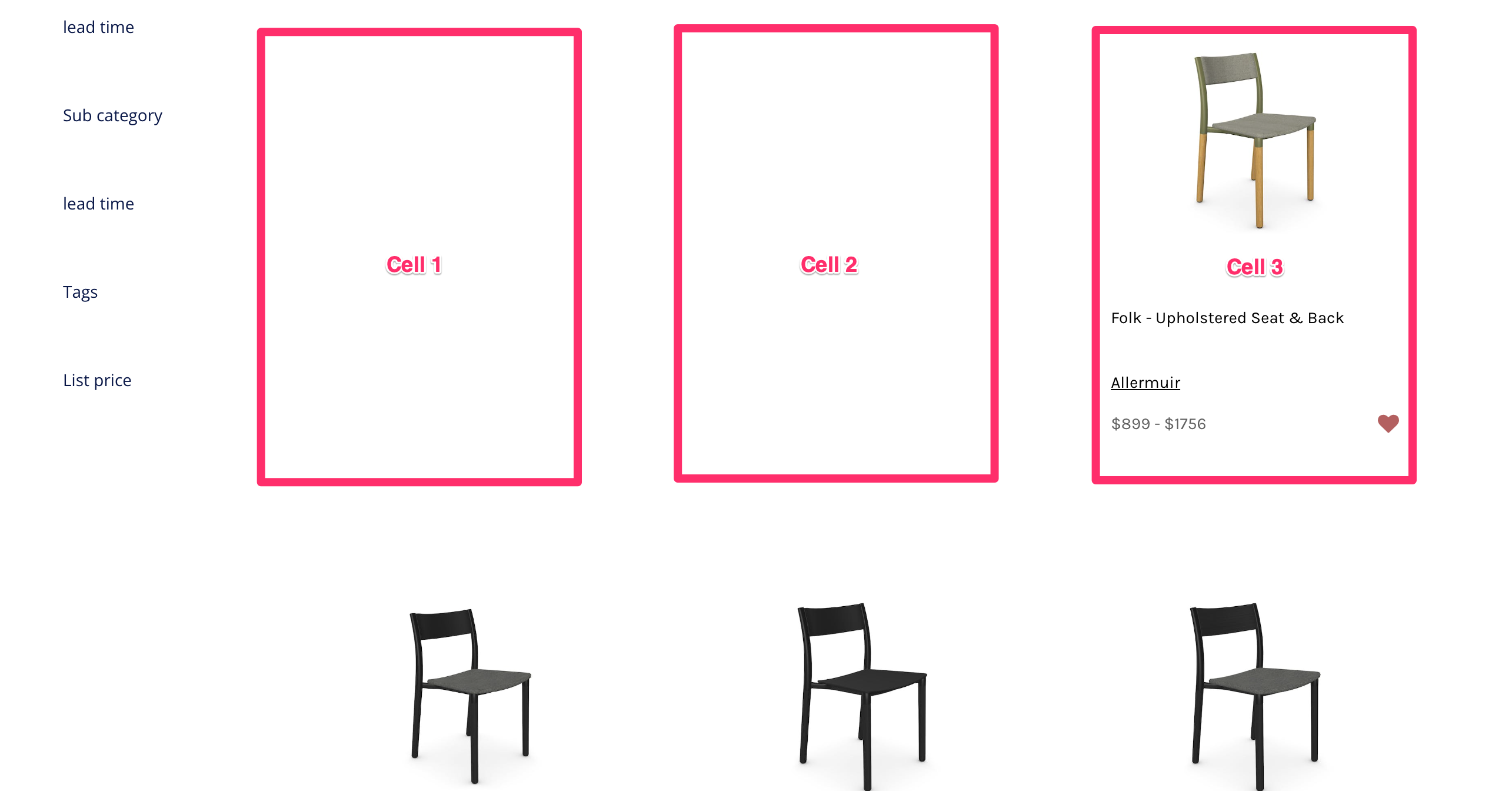

I have a Group ‘Product’ that takes up the entirety of the cell (width / height) and based on conditions I remove it’s visibility, but even when the Group Product is not visible, the cell is still taking up space (see cells 1 & 2 below).
I believe this is due to the set up of the RG, where I have a min width / height of 250 px for each cell, hence why the cell isn’t collapsing when I remove the visibility of the Group Product in the cell.

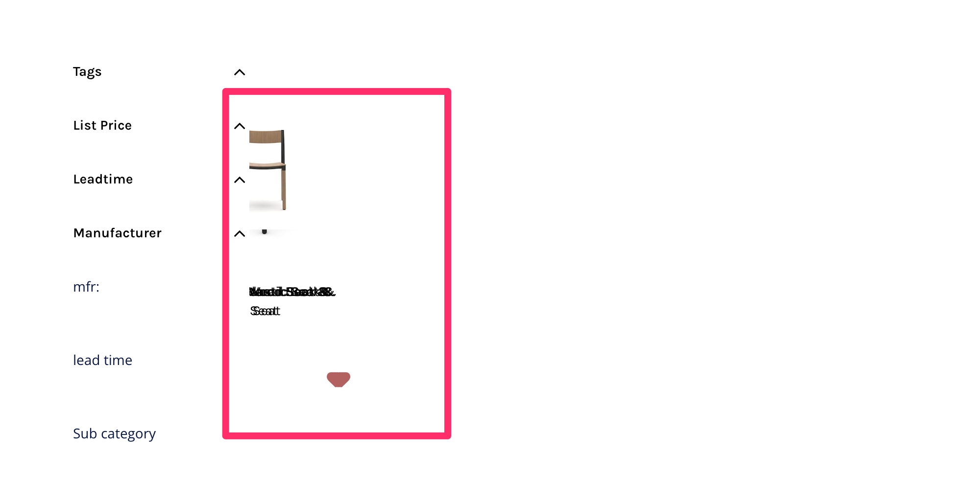

Masonry Grid - looked into this and ran into the same problem (see image below) where the cells overlap.

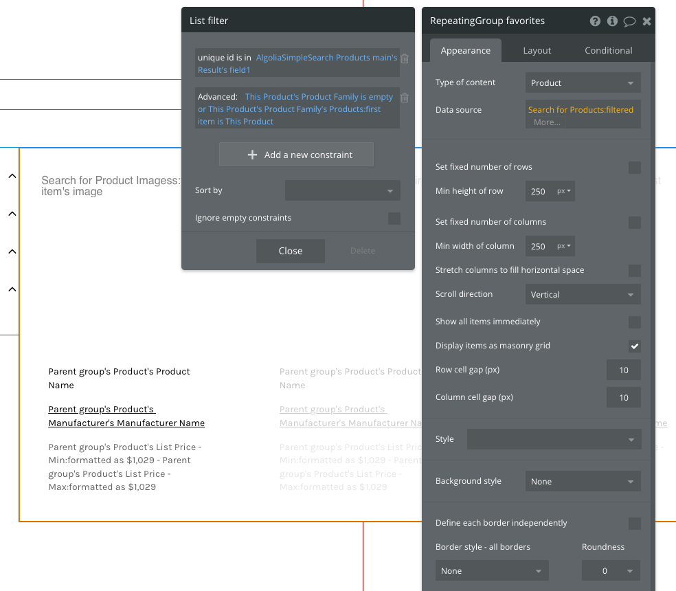

Filtering data source - this is the correct solution, however the problem I’m running into is converting a list of texts into a list of Products. Currently I’m get a list of text back from Algolia Search, then for each cell doing a search for a Product where unique ID = Algolia text.
Is there a way to convert a list of text to a list of Products (with conditionals)? I was playing around with Do a search for in the data source field but it wasn’t playing nicely.

Ended up going with the solution where I set the data type to product then filter using the Algolia results + another constraint I need.
