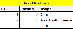

Right now I have 4 tables
- Foodplanning table (a row for each date. A row can point to several rows in the foodplan portions table)
- Foodplan portions (each row specify the number of portions and a reference to 1 recipe in the recipe table)
- Recipe table (each recipe contains the name of the recipe, total nutrient information and references to several rows in the recipe foods table)
- Recipe foods (each row is a food with an amount in gram)
I want to create a shopping list list either as a repeating group or in a backend table. If we take the 4 tables above as an example.
I choose to create a shopping list with foods for 16-apr and 17-apr (look at the food planning table). In the end the shopping list will look like this:
As you can see the portions have been multiplied with the grams in the food table for each day and then summed up.
However this has turned out to be quite a challenge in bubble. If I try to perform a calculation by using all 4 tables I am limited by:
- only able to sum all grams and then mulitply with portions - which will result in incorrect number
- when using sumproduct I am only able to multiply the portion with the first food’s gram
On the other hand, if I wish to save all the foods in a recipe into a seperate table when allocating a recipe in the foodplan then I am limited by the inability to creat several rows in a table.
Therefore how do I solve this issue? thanks for your time.
