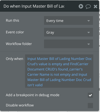

This is the conditional trigger
As can be seen I’ve added the breakpoint in debug mode but it never triggers
I’ve added the same exact expression into a text element onto the page in order to try and debug as it would logically be assumed it is my mistake with the condition and it doesn’t evaluate to yes, which would be why the conditional trigger doesn’t execute, but when that text element with the same dynamic expression is on the page, I can see it turn from no to yes at the exact moment it is supposed to. This implies no issue with the condition, which then implies a bug in bubble.
BTW, the dynamic expression was crafted originally in the condition on the conditional trigger so the input isn’t valid operator is available to it in the workflows conditional expression.
