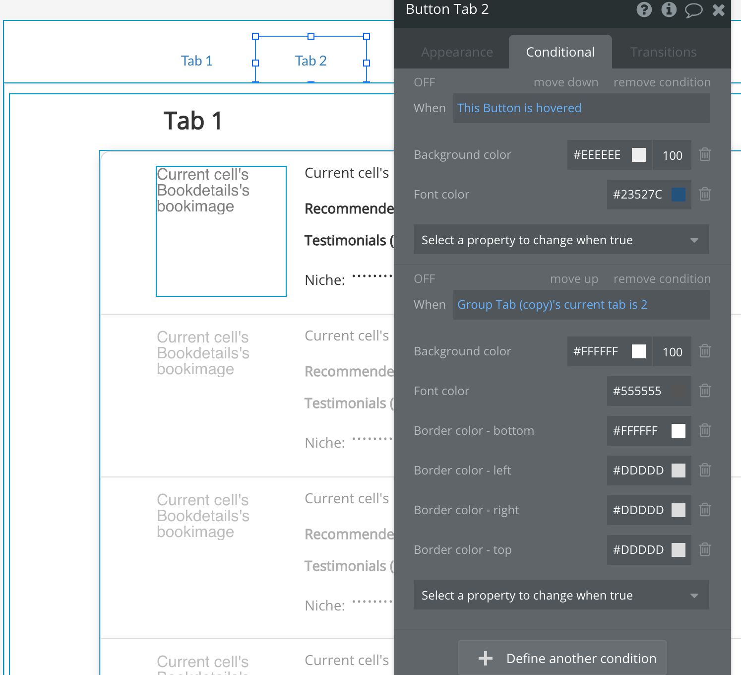

However, when I click Tab 2 on editor to build an RG similar to the one built for MostVoted tab, the Tab2 content space is not getting empty. How would I be able to create an RG for Tab2? Kind of lost here, your help is very much appreciated. Below is the screenshot for reference.

@sridharan.s The Content Space I’m referring to was the Repeating Group(Tab 2 Content), please refer to the screenshots below.
I like to create a Repeating Group for Tab 2 similar to the one created for Tab1.

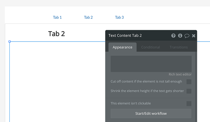

Hi @fayewatson, I was able to create RG manually in the other tab content area. However, when I’m trying to copy Tab1 content with workflows and past it to Tab2 content, it is ending up pasting the copied content on top of Tab1. Before I tried to paste the content in Tab2, I kept Tab1 in hidden mode, yet it still doing the same. Am I missing something here?
Awesome! :slight_smile: Can you share a link to the app editor? If not, I would try clicking on the Tab 2 Group (so the blue border displays in the editor), and then within that group, right-click and select paste with workflows. That should place the content within the Tab 2 group, but let me know if not!
@fayewatson I did try to highlight the Tab2 content section first before trying to paste. It did not work for me.
Below is the link to the app editor:
Ohh I see; It’s because the element within the Group 2 Tab looks like a group, but it’s actually a text element:
Delete that element, and then you can paste with workflows the repeating group within the group called “Group Tab 2 Content”.
