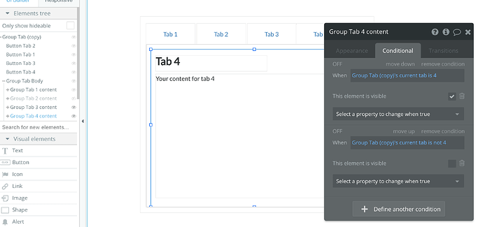

Then to make sure that Group Tab Content 4 is only visible after the Tab 4 Button is clicked, change the conditional formatting on the Group Tab 4 Content to be:

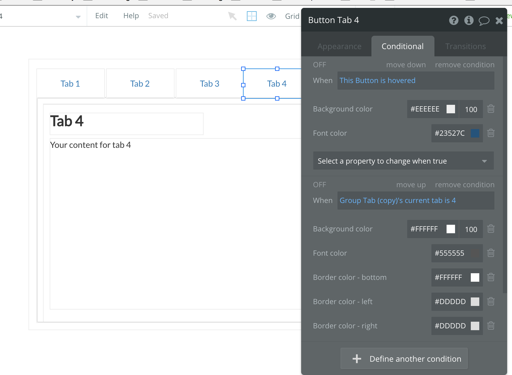

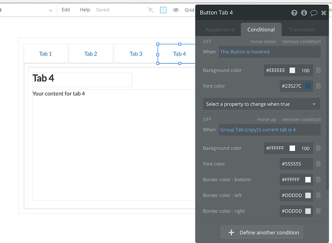

Last but not least, change the conditional formatting on the Tab 4 Button so that its formatting changes when the custom state value is 4 as well:

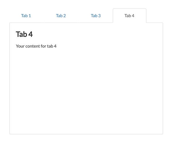

In preview mode it should look like this:
