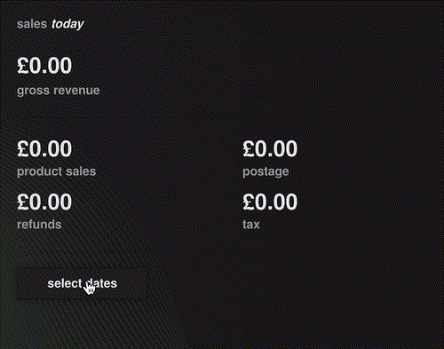

Now you have a completely customisable, natively built calendar. I’ve added some additional flourishes to mine, but this can obviously look however you want it to:
