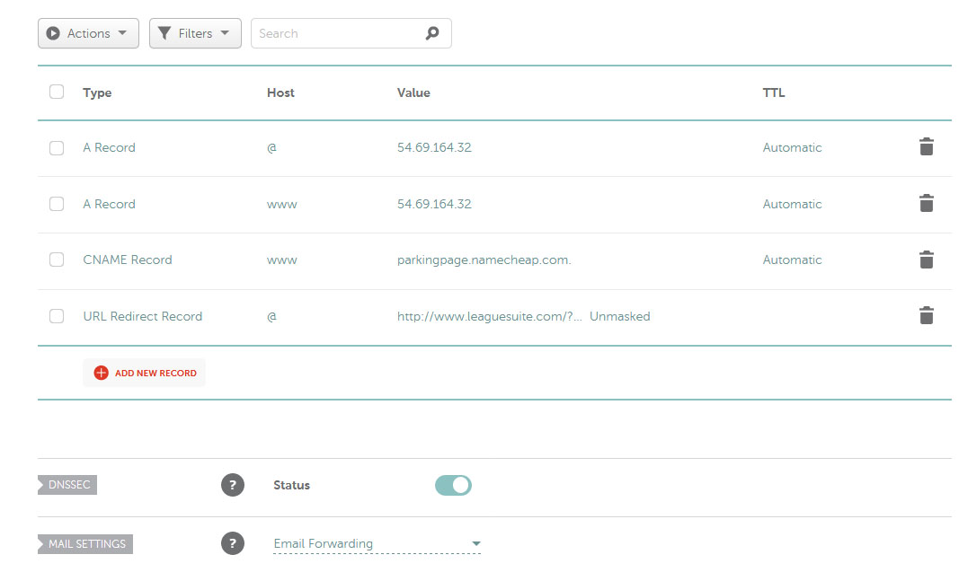

hey,
i set up the A records but cant setup email and ssL yet what could be the problem? my app is online already
well this is outside bubble ‘tech support’.
for email you need to setup MX records as for SSL, it’s automatically enabled on bubble.
please take a look at my records and advise why, Bubble isn’t able to verify my A records till now.
First time am doin this
kind of thing… must be missing something
Try removing the bottom 2 records.
You mean CNAME and URL redirect?
Namecheap and the one below it.
okay done that. Will revert in a while
