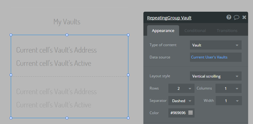

I must admit, this seemed to have broken when I changed the Vault field to a List, as we made a decision to allow a user to create more than one Vault.
I am displaying the list of Vaults that is related to a User on a repeating group as such;
I then have a simple shape that when clicked navigates to the repeating group as mentioned on my first post above.

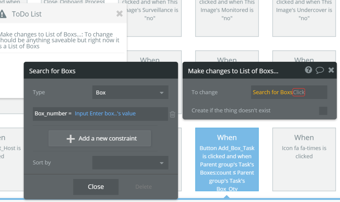

In the screenshot below I am initially searching for the Box_number that matches the one entered in the input field.
Issue here is that it appears that the ā€˜Search For’ return a List of boxes and its throwing an exception.
after so many hours later I managed to work this issue out.
I figured out that as all searches come back as a list of Things, in my case above I am being explicit about the item that should return so I am confident that the list only contains one element and therefore can specify that I am wanting the :first item
this seems to work perfectly! :slightly_smiling:
Glad you sorted it :slightly_smiling:
That is a common Bubble search issue, no matter how much you know it will return a single thing … a search is a list as far as bubble knows.
