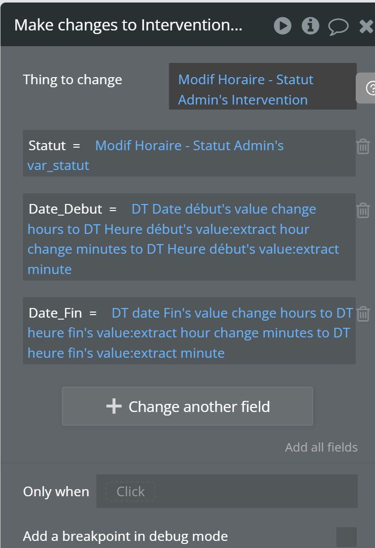

Hi @dev.otofu ,
It seems you use a wrong function to achieve your goal.
I did the same error.
You must use this kind of function :
It’s in french burt you can easely understand the sense.
Hope it helps.
Jean-François.
Hi @marynissen ,
Thank you very much for your kind reply. Thanks to your advice, I was able to get it working just as I expected!
