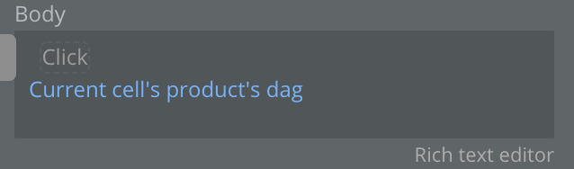

I’ve noticed something very strange with dates. The raw data is correct but when displayed or extracted I get the date minus one(1) day and minus one(1) hour. Has anyone noticed this too?
When displayed:
From the database:

Thanks for your reply. So I have a field of type date. I save a date to that field from an input of form date. No problems with that (or at least what I think) When I display that date, eg. in an email, I get the date but minus one day. See the images above.
I’ve reproduced the issue here:
https://www.rempah.se/version-test/test1?debug_mode=true
It’s the exact same expression.

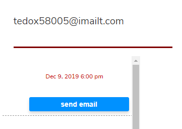

OK so this is expected / normal behavior. You did not account for the timezone conversion. Let me explain.
On the browser you pickup the users timezone. Witch in my case is this
Then on the body of the email you are basically telling bubble to use its Time Object ion the body. So bubble converts this time to UTC and sends out the email. To solve this you will have to change the timezone to what ever the user is in.
See here. 6 PM for me is 11 PM UTC
In summary this is whats happening
Browser Time > Server Time > to text in body as static

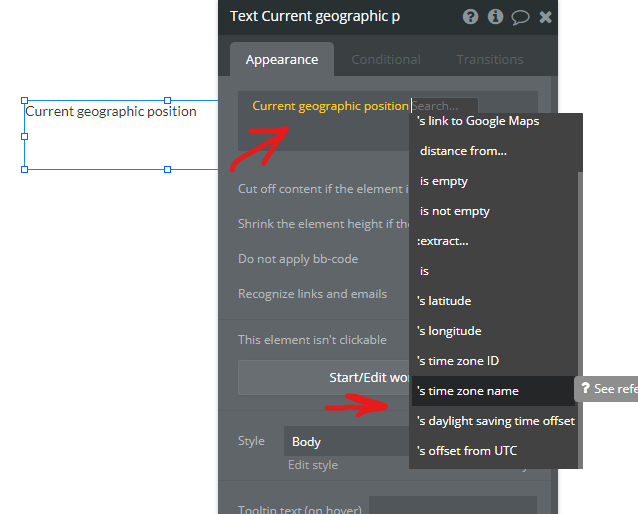

@AliFarahat is there a way to get the UTC offset of the users browsers timezone?
Yes, See here
@AliFarahat
Thanks for pointing that out to me. I was unaware that these functions were available.
After testing it out, it doesn’t seem to be giving me the correct information unfortunately.
