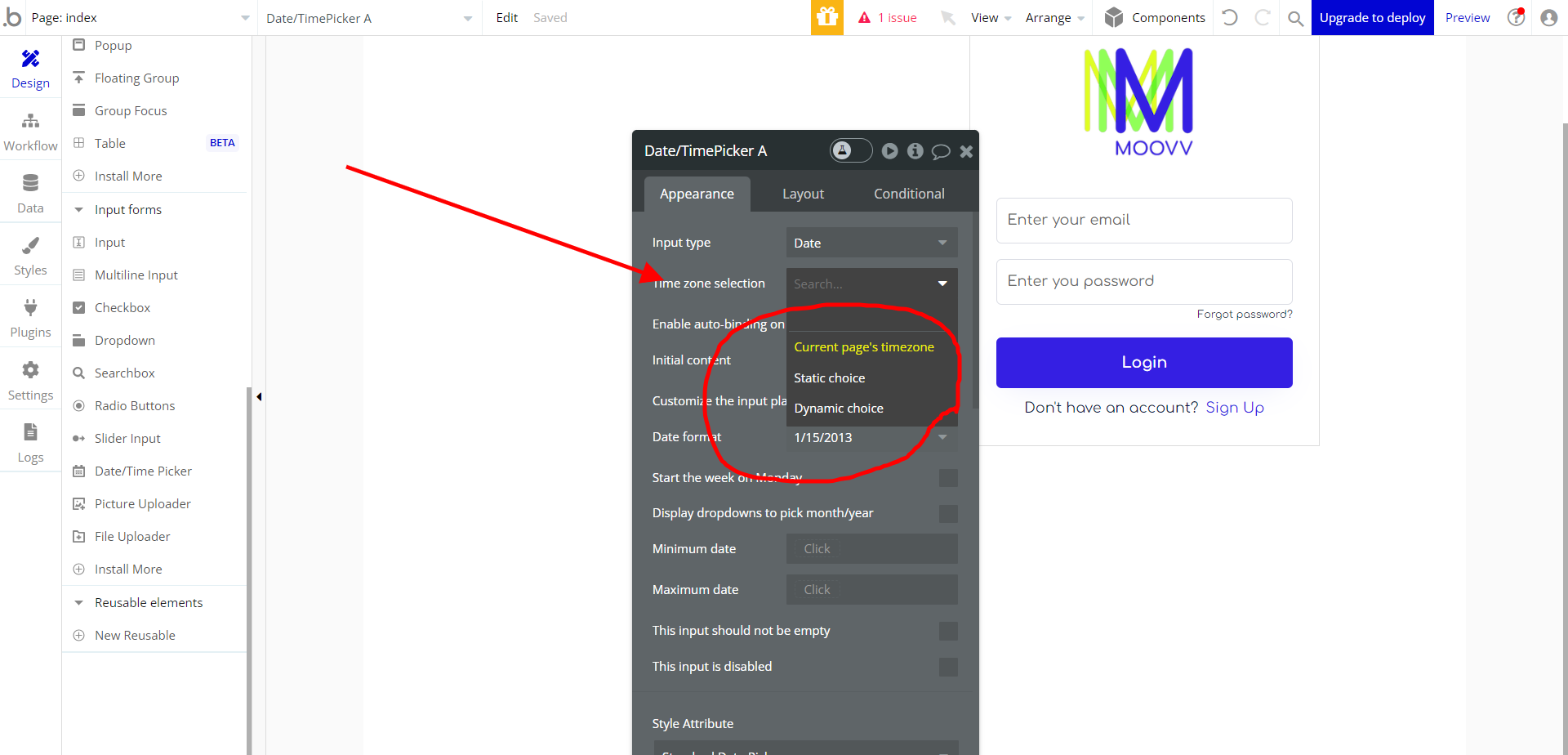

You can override the default time zone settings and choose the time zone you want all date/time values to be stored in.
Bubble will still convert the values to UTC in the DB.
Before if two people A and B in UTC+1 and UTC+2 respectively pick 3PM in a date/time picker, the UTC values stored in Bubble will be 2PM and 1PM respectively. But now if you override the controls and select all time zones to be UTC+2, then Bubble will store the same 1PM UTC for both persons regardless of their current location’s time zone.

After checking the boxes, you’ll have to do one or both of these as well.
  • The first one, if you intend to do the override at page level, you’ll set the time zone you want.
  • The second, if you intent to do the override in teh datetime picker, you’ll set the time zone you want.

The last two screenshots I shared, can you share the one for your app? The time zone in the date/time picker and the time zone of the page (if it was checked)
