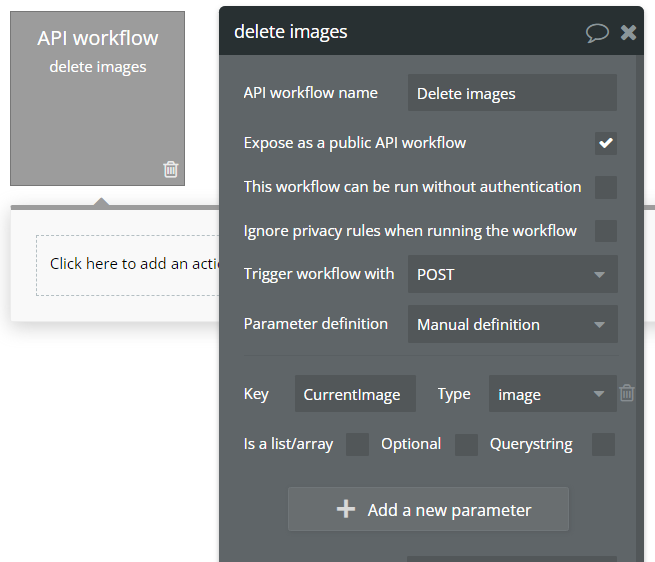

Here we can create a “New API workflow” and add a new parameter.
You can call this whatever you like, but make sure you have the correct data type selected!
Make sure you’ve not set this as “Is a list/array” as we need to process images one at a time.
Final step for this workflow is just adding the “Delete an uploaded file” action with the URL being “https:[parametername]'s URL”. (You’ll want to add the ‘https:’ yourself as that is usually omitted)
